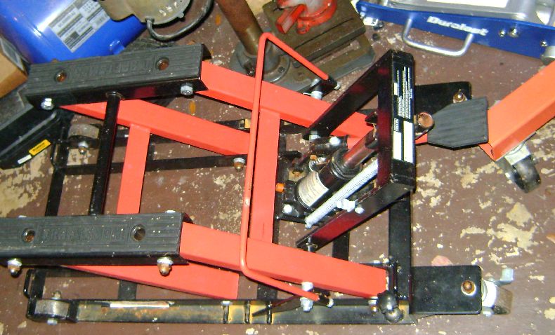

                ATV JACK...
                You might want to try something like I did with my W-Body. The engine is turned 90* but, the concept should be the same. I was able to jack the car up onto truck/tall jackstands on the front and regular jackstands on the rear and NEVER have to raise or lower the car again until done. The magic came in the form of a Sears ATV jack. Drilled a couple of holes in the "pads" of the ATV jack and screwed on a couple of pieces of 2x4. The cradle rested solidly on the 2x4s and I was able to lower everything down and roll it right out from under the car and wherever else it needed to go. When out from under it made a REAL nice, stable work platform, you could lower the 2x4s onto regular jackstands. I might add that I had NO help,,, at ALL!! Not bad for an old one legged man,,, ayyy? Here's a link to the thread for my engine/trans swap.. You can see the ATV jack in just about every picture....
                http://60degreev6.com/forum/f101/eng...ny-swap-t38381
                If you need any more details,, holler!!!
                Tom....
                Tom... Excellent photos of your set up and as it happens...only yesterday I was lamenting to my neighbor how tough this job would be if I had to try and support the transmission without the aid of a Jack designed expressly for the purpose. Lo and Behold...he showed up early in the day with what he called a "Motor Cycle Jack" (its and ATV Jack) with a long "T" Bar handle. It look just like the one you used (prior to the two-by mods). So between what you have shared and what John (Forced Firebird) has explained below...I'm sure to come up with the best of both solutions!
                Oh... and just so you know...in a Fire Fight... My money is one the OLM (One Legged Man)... the reasons being is that he never bothers to even think about the option of trying to run away...and that certain knowledge steadies his mind...and his aim, too . Thanks a lot, Tom.
