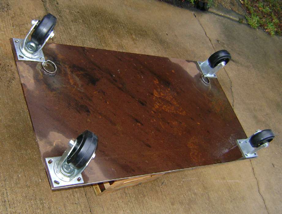

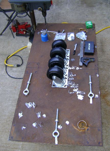

              #21

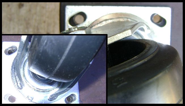

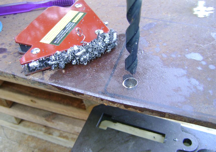

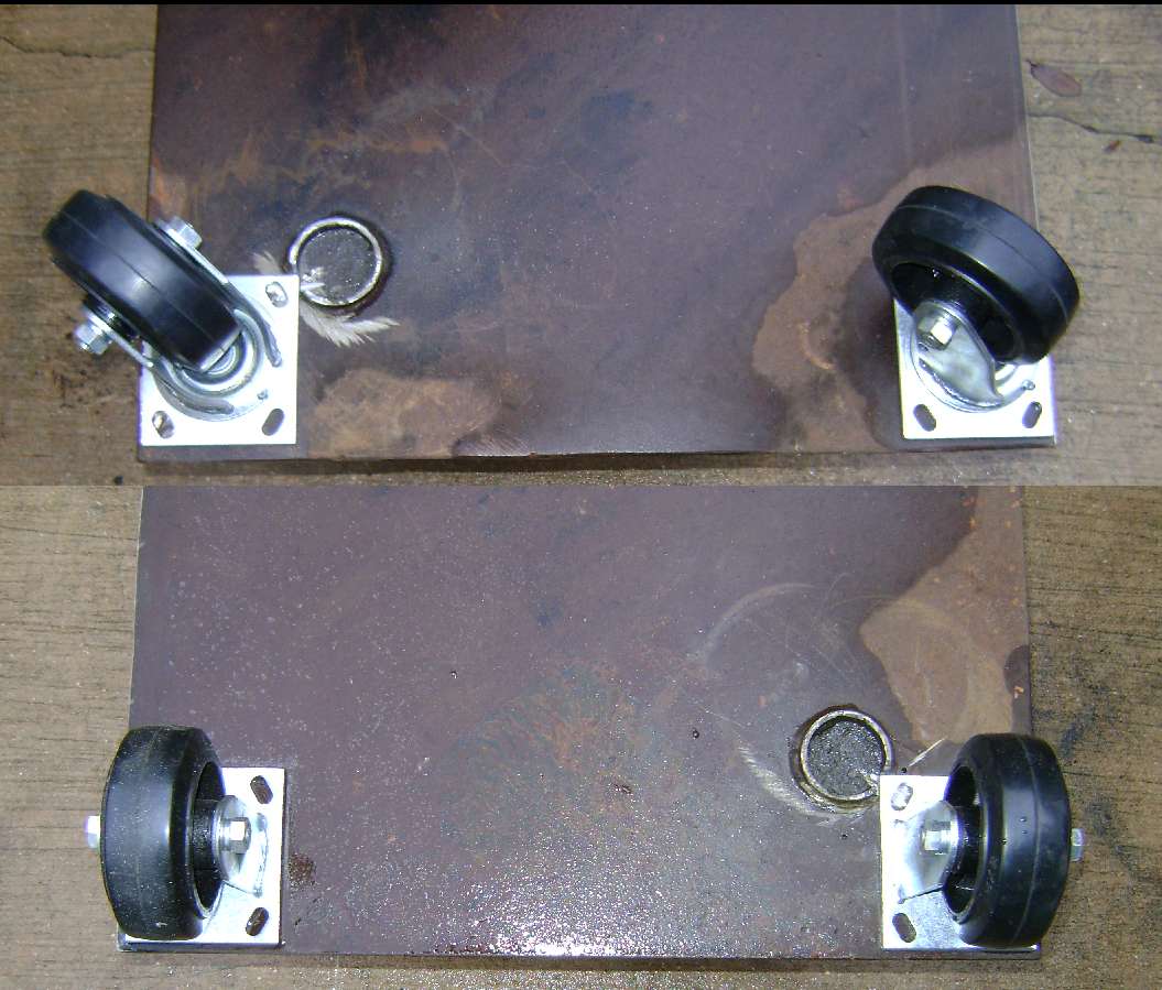

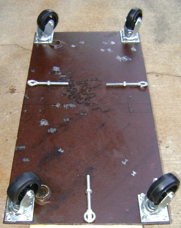

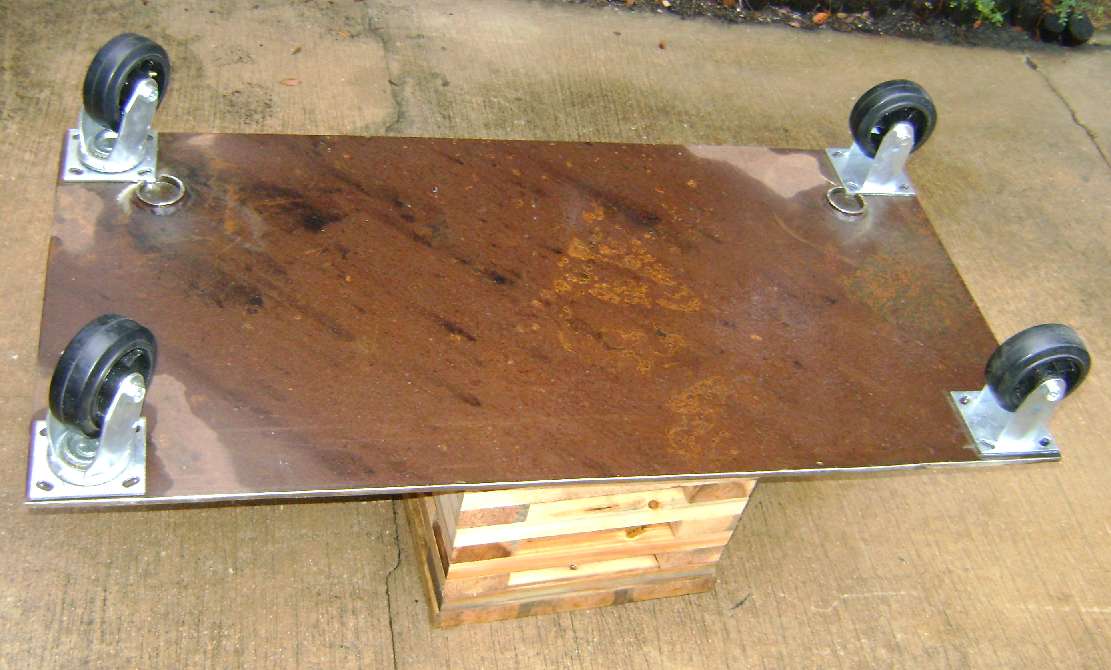

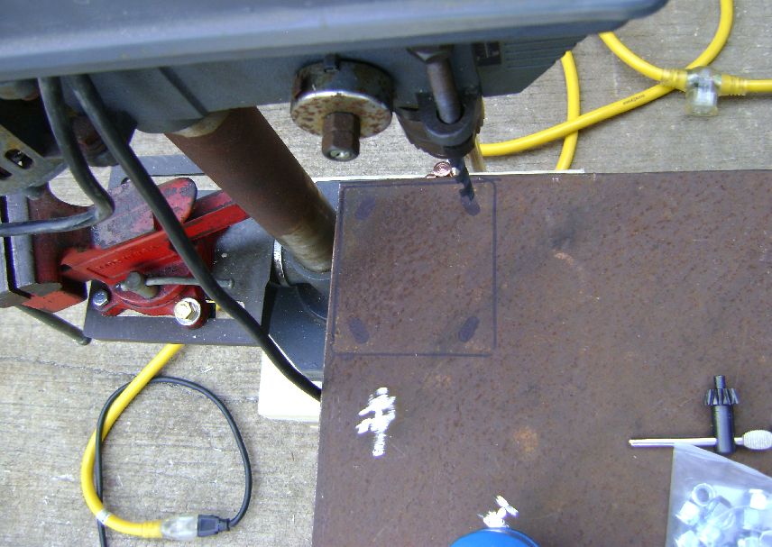

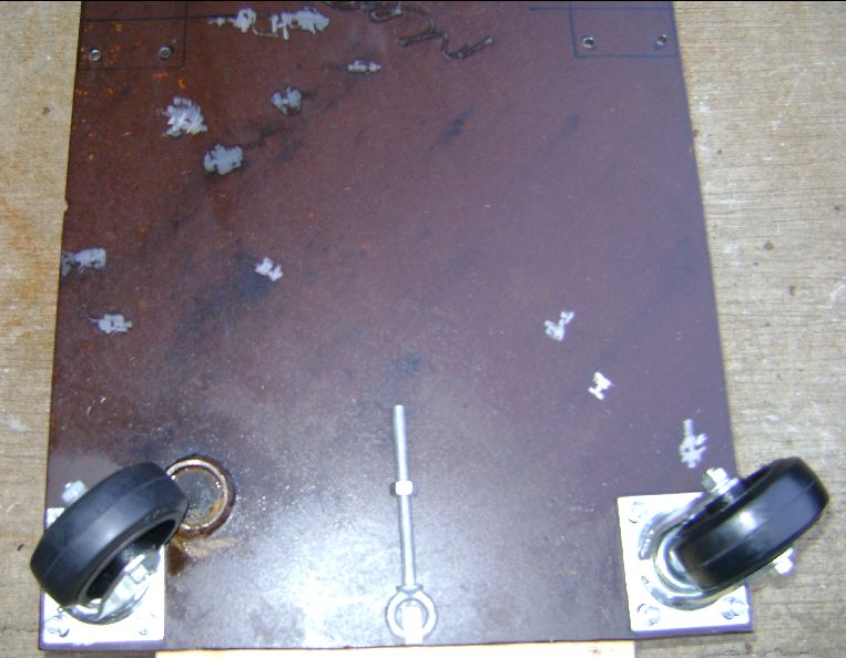

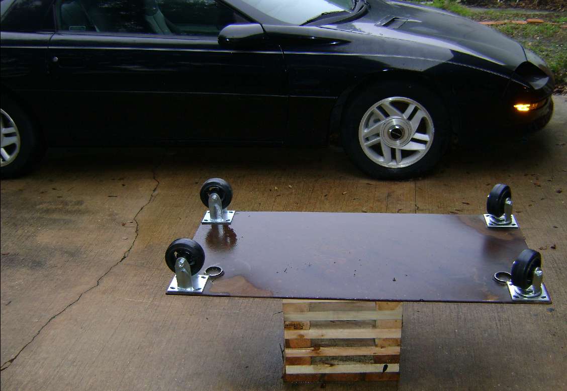

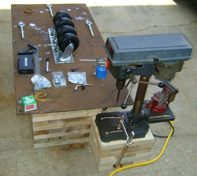

              The Steel from the Welder's Table is Prepped...
              As usual... Visual Cliff Notes provided for those just wanting the "Short Story"
              Okay... I dodged a Dollar Bullet this morning by coming up with a more practical solution to cutting through that damned Welder's Table... My suggestion is that if you decide to follow this example in "over-building" your own cradle, get some 7" (Thin) Aluminum Oxide-Carborundum Cutting disks and mount one (it will only take two do cut about four feet of half-inch Cold Rolled Steel Plate) and have at it!
              The only thing you have to be careful of is to remember to carefully manually lift the Blade Guard or the back of the 7" + 2.5HP Circ Saw will catch on the narrow edge of the steel plate. Wear ANSI approved equipment when doing all of this (Welder's Leather Apron and Gloves...Full Face Mask...Heavy Jeans and a Long Sleeved Shirt). Mind how you set your work up to remember your "Spark Trail" is long, very hot and with accumulation of waste metal "scabs"...capable of setting your clothing on fire...(and that can of Gasoline on the floor right behind you). I recommend that you do this job outside using grounded tools and extension cords and keep a Fire Extinguisher and a Water Hose nearby.
              After you are set up to work safely... Use your grinding-cutting tools with BOTH hands. With steady pressure and some patience in watching your "Scratch Line" for guidance, you should wind up with nice, clean cut edge. DON'T FORGET TO GET SOME SOFT EAR-PLUGS TO PROTECT YOURSELF FROM GOING DEAF!. And the last prepping suggestion I'll make is...have some pity on your neighbors as to what time and for how long you intend to work on your steel-shaping project.
              To prevent getting permanent nerve damage in your hands and arms from the constant and excessively high frequency vibrations... take a break every fifteen to twenty minutes... stretch your legs and your back and go TAP and get a cold drink. Leave the alcohol for AFTER...because at the end of the day, you'll want to have all ten toes and ten fingers and both of your eyes...right? Watch for loose or hanging clothing and garment straps from getting snagged and rolling you up into something spinning faster than the redline on your car engine...If it happens...if you are still conscious ...or even still alive...you will NOT be able to turn off the thing that just inhaled some of your body parts!
              Once the major cutting of all that steel is done, remember to dress up the edges of both sides of the cut work for razor sharp edges and some left-over "Razor Blades" that can shred your fingers and Blue Jeans if you get snagged on any of them. Get a Yard Magnet on a Stick and glom all that sh*t up to prevent it from either being ingested by the cars in your driveway...or worse yet...wind up in your Kids' bare feet...or even a tire or two. It won't hurt to clean up the look and feel of the finished cut edges with a Bastard File and that pretty much takes care of the problem.
              The reason I chose the dimensions of 24"W X 48"L X 1/2" for this job was that I measured well up into the splayed legs of my Cherry Picker Hoist to make certain that the outer edges of my "Engine-Tranny Tray" would not be prevented form getting properly positioned under the K-Frame Member and all that is behind it... by bashing into the legs of the Picker and finding it impossible to get it properly placed under the car.
              The nice, flat steel surface allows for some "fudge-factor" if the assembly requires adjusting to get at the various mount bolts from the Transmission Cross-member Support Bolts and up front where the lower bolts must be removed along with those holding the strut towers in place. The same idea applies when the whole apparatus has to be wheeled back in place for the return trip with a new motor in tow.
              My choice of wheels might be considered a luxury at $12.00 a pop for the assembly...but they roll so free and easy and will never bind as long as all three grease fittings are used to prime the double roller ball-bearing sets with grease to make turning and adjusting all that weight much, much easier to do when it comes time to align everything.
              Don't forget that the other half of steel plate is also 24" X 48" and is just the right size I needed for my own "Real" Welder's Table. When the four legs are leveled, tacked in place and welded symmetrically back on the excess piece...I'll finally have a decent one. The other thing not known to all you as of yet is that back in the days when I was a competitive shooter, I used to mine the berms and safety banks behind the ranges, finding literally tons of Bullet and Rifle Lead. After smelting the dirt, old brass and rifle bullets out of the molten mess... I would pour the remaining lead (nice and "Linotype' hard for comp shooting...with minimal "bullet-wipe" and very consistent ballistics as a result) into corn cob ingots and save the stuff for future bullet making.
              Even after thirty years or so... I still have several galvanized garbage cans filled with these lead ingots. The problem though is that they sit on a practically immobile steel wheel cart that is a Stone Bitch to move or get around in the back of my garage. But when the Engine Swap is done...I'm thinking about adding a third set of the spinner wheels to the mid-section of the Engine-Tranny Tray... and then use IT to caddy around all that heavy lead stuff.
              Tomorrow... I'll take a scale digital image of the bottom side of one of the wheel brackets and print up four of this image to tape in place on the four corners of the steel bed and then drill me out the sixteen holes with my drill press. I'll just find the right height on each corner and set the edge of the steel plate on top of the Drill Press Table and that will make very quick work of drilling all 16 holes, very straight and true (pics to follow). Then I'll drill two centered and aligned holes in tandem about one inch in from the edge what will be the "Front", and the left and right sides of the Tray...and bolt in two sturdy "Eye" Hooks on the under side of the Tray at all three positions. Afterward... I'll take the "Bag-A-Boltz" that include round head tops for the top and large flat and locking washers with lock-nuts and after aligning the wheels ...Ill bolt everything up and tighten them all down. The tray will be reading for a test drive after that...but I'll be careful not to sever a toe or two when flipping it over at 185#s in weight and then onto the new wheels for a spin around the driveway.
              These three "Push-Pull" positions will allow me to attach either a Nylon Pull Ropes...or... I have an idea in mind to make a long "T" Handled Re-Rod Push-Pull Bars that will slide inside the two "Eye" Hook holes on any of the three sides and allow my Spotters the chance to move and adjust the entire Tray with excellent control...without having to break their backs or mine...or be too close under the car to do it... (pics to follow).
              It was a very gloomy and rainy day today... but my Driveway Weather Report had a little Sunshine to appreciate when this Damned Job was finally done.

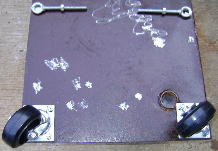

                          Went to Loew's this afternoon and decided to pick up two more sets of 5" Full Roll-Around Wheels after thinking that being able to move the Engine-Tranny Tray in any direction on all points of a 360 Degree Radial made more sense than only having the ability to adjust in this manner on the two front wheels. There will be Three (3) Sets of Wheels now instead of only two ...because I thought that the longer length of 48" might flex downward enough if the weight of this entire group of machinery might be enough to bow the flat steel plate all the way to the deck. This way...I've eased my mind on that score.
                          Also...I have acquired two more "EYE" Hooks in order to mount one on either of the long sides of the Tray with also having one in the front so that all three can be used to manipulate the Tray with great precision...without putting my Spotters in any jeopardy. I simply have to tie nylon ropes to the three "EYES" and then thread the ropes through 1/2" by 4' lengths of White PVC pipe... and this way the Tray can be pushed, pulled and adjusted on three vectors when it comes time to lower the car back onto the entire assembly with the New Motor more easily to attain the necessary alignment needed to get all the K-Frame Bolts re-installed and the Shock Struts into the Towers lined up right. As Robertisaar might say..."Maneuvered? No...McGuyvered? Yes!"

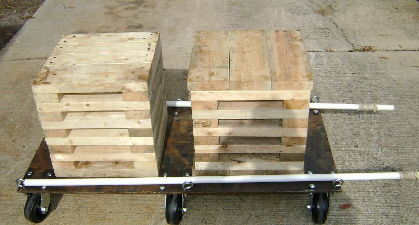

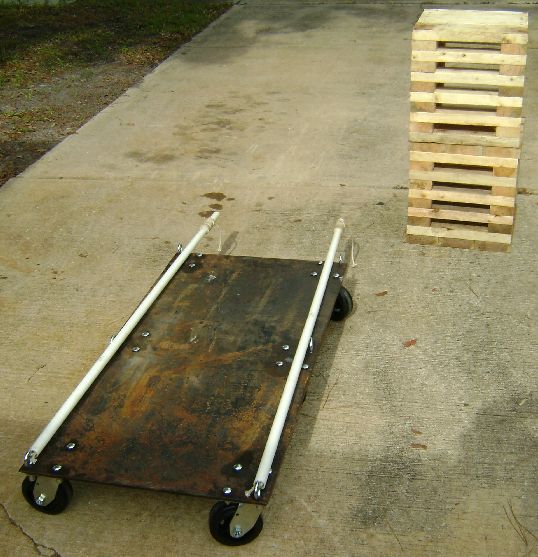

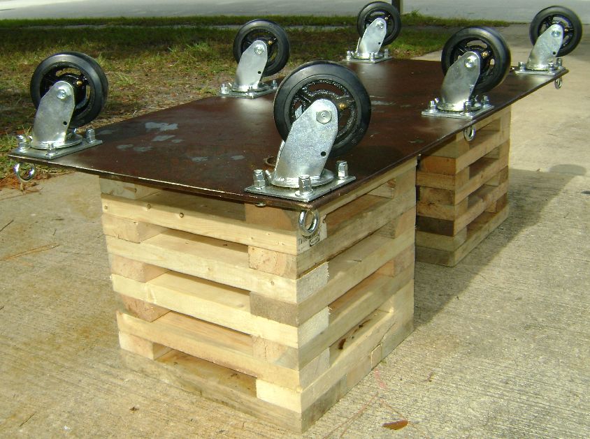

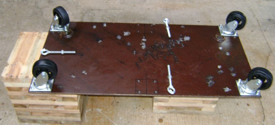

                            The Follow-Up Engine-Transmission Cradle Assembly Images and Videos can be seen here:
                            Okay...
                            I finally managed to find the time and the inclination to get the 24 of the 27 necessary holes drilled into that heavy plate steel platform that the Engine and Transmission will soon be resting on. I'm glad to have had a portable Craftsman Drill Press because drilling out 27 holes (4 per wheel unit X 6, plus the three needed for the EYE Hooks) through 1/2" gauge cold-rolled steel ...is harder on your muscles, your hand drill and the drill bits that could be ruined while trying to make them all symmetrical and true than you might think at first blush... assuming of course that your back holds out to the end of the job if you choose to do this the Hard Way.
                            And so... following on with the design of the "Jack Stand Towers" using the 2" X 4" X Whatever is required in the various lengths... in this case I needed to design and build a platform that would support my Drill Press well enough not to have it "Golly-Wogging" down my driveway (this phenomena happens because so much of the mass and weight of the machine sits so much higher than the lighter wooden base it is resting upon that it tends to "walk" forward or backward with increased pressure on the drill bit)...and yet , still be light enough to lift and adjust from one position to another around the perimeter of the steel plate to efficiently get all of the holes drilled... I constructed what was needed as a 9" X 12" stand that I just clamped to the lower table of the Drill Press so it would not tend to walk off while vibrating so much when operating the drill. At various times during the drilling process, I used a Shop Magnet to collect the spall shaped, razor edged cuttings and later used a magnet wand to pick up every last bit of the stuff before it can migrate into anybody's bare feet or get ingested in the engines of our cars. Naturally... having an Oil Can nearby to lube the drill hole and cool off the drill bit helps ...regardless of which drill tool you choose to do the job.
                            My decision to use six wheels instead of four feels better because I'm confident now that now matter how heavy the entire assembly turns out to be...even if its over 1,500 lbs... this Engine-Transmission Cradle will bear up nicely under all that weight and free-wheel well and truly when being moved out from under the car and when being slid back in place to lower the chassis down on top of the works.

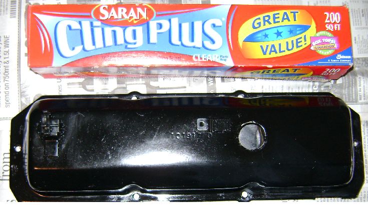

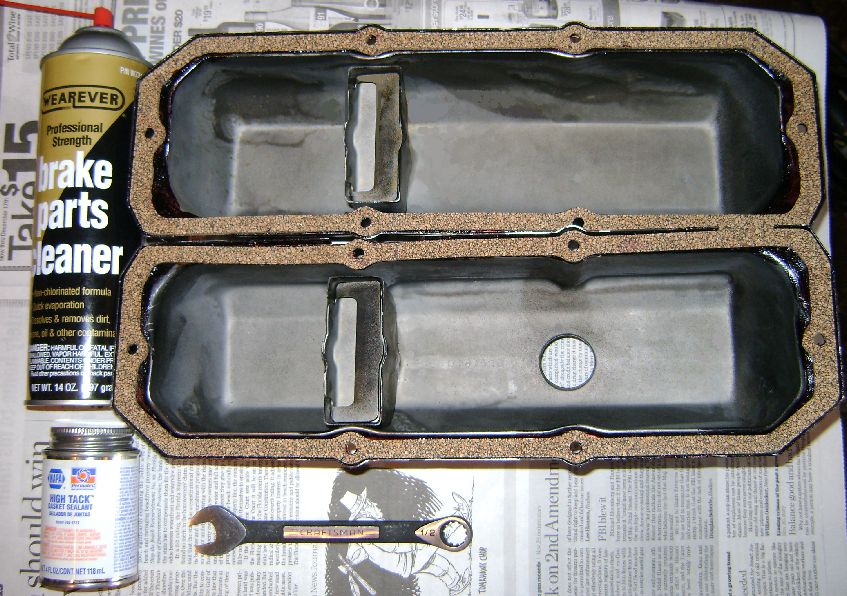

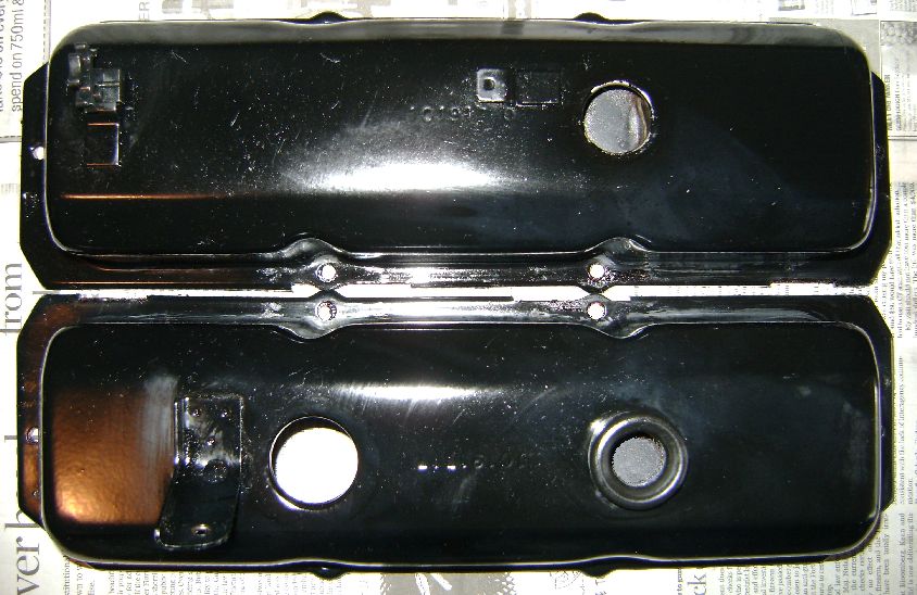

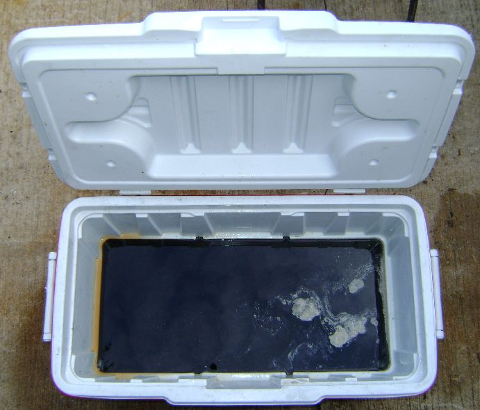

                              How to Clean and Prep Old Valve Covers:
                              Okay... Today's example of this serves to kill three birds with one stone, The insides of the Valve Covers on this little V-6 Engine were exposed to the sloshing action of millions of cycles of pumped motor oil... much of which became dirty over time from ingested mung being breathed in and making its way past the ever loosening rings on each piston. They were also exposed inside to all that unburned fuel and burned by-products of incomplete combustion that included noxious, dirty and oily vapors that serve to literally varnish the insides of the covers over time and in this case...at nearly 100,000 miles...they have become "less than sanitary" inside... to say the least.
                              But... with the right sized closed container and concentrated cleaner... you can easily bring back the newness and cleanliness of these important and protective sheet metal containers...without breaking your balls with using dangerous solvents and cleaners and more elbow grease than you might think to dedicate to these three pieces of "Tin" (The Third Man (bird?) in this story is of course...the Oil Pan...but THAT is for another story)
                              In my case... I use a Very Large Coleman Cooler as my sealed container to hold the fresh batch of a 50/50 mix of my favorite Concentrated De-Greaser and Cleaner called "Purple Power" and plain water. I simply fill the cooler to a level at least one third as wide as the piece(s) I need to cover with the stuff...and after removing any plastic or rubber removable parts or grommets...I just submerged the two Valve Covers into the stuff...close the lid...and walk away.
                              Since I'm NOT using anything Aluminum...I don't have to worry about bad things happening to the Mild Steel Covers and I don't have to be concerned that the Black Cover Paint will be dissolved either. Three or four days later... I checked on the progress of the two covers and decided to leave them in a bit longer since I was not in a rush to get them ready for installation. After five days... I pulled out the two covers...then hosed them off in the driveway and IMMEDIATELY sprayed them down with some liquid wrench to prevent the normally munged up but essentially rust-proofed via the old oily junk on them, inner surfaces from rusting up in very short order.
                              Then ...after getting my materials together I did the following:
                              1. Carefully Scraped and Cleaned the Inner Race areas of the two Valve Covers of all traces of any and all old adhesive and Cork Gasket material.
                              2. Sprayed both covers down very well with Brake Cleaner.
                              3. Applied a thin layer or coat of NAPA Hi-Tack Gasket Sealer to the inner race of each cover and allowed them to sit for a few minutes.
                              4. Applied a thin layer or coat of NAPA Hi-Tack Gasket Sealer to the matching sides of the cork gaskets and allowed to sit for a few minutes.
                              5. Carefully inlaid both Brand New Cork Valve Cover Gaskets while aligning the mounting holes and mating surfaces between the two surfaces. If you were not careful during the application of this stuff and you have drips and drabs of the NAPA Hi-Tack stuck on everything...not to worry...Spray some Brake Cleaner on some White Tee Shirt material...and it will come off the surface of the Cork Gaskets...your fingers...and here is another tip...wipe down the outside of the Hi-Tack Container too...and the next time you reach for it...you won't stick to the can!
                              6. Finally...and this is the part that gets skipped too often... Take the rounded side of a 1/2" Box End Wrench and use it to gently work the Cork Gasket into a fully seated position and get all the air bubbles out between it and its contact with the cleaned up metal rail surfaces.
                              7. After they sit for a half-an-hour or so...spray down the exposed inner metal surfaces with either WD-40 or Liquid Wrench.
                              8. If you cannot install these covers immediately... Save yourself the grief and the time and effort it will take to clean them up all over again after leaving them laying around until they have to go back on the new or re-built engine heads...by simply WRAPPING THE VALVE COVERS IN SOME SARAN OR CLING WRAP! Also...WD-40 WILL evaporate over a short time frame!
                              9. Two Days... or even Two Years Later... when you are ready to install those "Freshened Up" Valve Covers... just unwrap those Puppies...and Bolt Them On... No additional cleaning or prep is necessary.

                                #30
                                For the Final Images and Demonstration Video of how the construction of the Engine-Transmission Cradle and Wood Support Towers turned out... Please visit this site:
                                Okay... The cold rains finally stopped and after the Sun broke through the clouds long enough to do any good, I rolled the Engine-Transmission Cradle out onto the driveway and finished installing the remaining two wheels for a total of Six (6) and swapped out one(1) of the four (4) bolts for each of the six wheels holding them to the 1/2" x 48" x 24" Plate Steel platform for Six (6) "EYE" Bolts instead of using only three (3) positioned at the two sides and dead center on one of the long ends of the cradle.
                                It occurred to me since last working on the item that I would need the ability to move and control the platform from any number of positions, for any number of heavy lifting and transporting of engine/transmission/rear-end components in the future, so I might as well anticipate the need and put Control Points at all corners and both sides as well. After I tied on two lengths of rope and fed the lengths through two five foot pieces of white PVC pipe, I pulled the ropes tight and just wrapped the cord around itself to make a handy place to grip on the far ends of both pipes. I shot a short video to demonstrate how this last addition and idea worked out to make the moving of this nearly 200 lb Engine-Transmission Cradle was and how easy it will be to control when moving the Old Engine and Transmission out...and the New Engine with Transmission into place for the re-installation that is yet to come.
                                The next installment will cover the re-brazing of the Oil Pump Pick-Up Tube to the Oil Pump and perhaps the installation of that assembly onto the Engine. I'm fighting some abnormally inclement weather and very windy days which make working in my garage too much like a dungeon with the garage doors being closed...but as soon as those things level off...I'll be 'turning to' on working with the last of the Engine Assembly.
