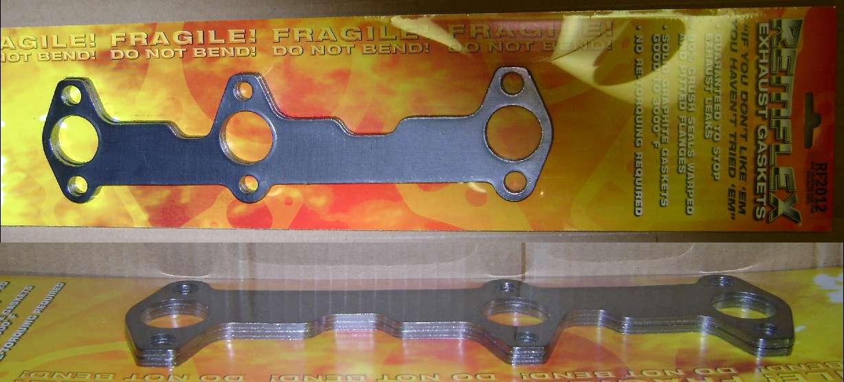

I still have to wonder how the installation of this set up will go with the Pacesetter Headers bolted on high and tight with the ARP Bolts from a Honda Civic Pressure Plate squeezing the new RemFlex Graphite Header Gaskets. I'm hoping I can completely dress the engine before lowering the car on top of the new Engine-Transmission... without squashing or denting any of the header piping.
