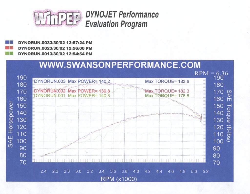

    I have a dyno from a stock 3.4, but not with the base tune I created using the 3.1 $88 values.
