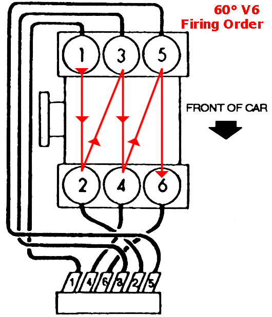

                              Just in case there is any doubt on the two issues of the location of the #1 Cylinder and the proper firing order and spark plug and ICM wiring positions... This is for the 3400 but should still apply here...
