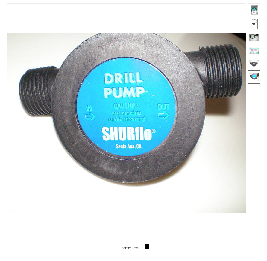

                            Pocket-Rocket... I just don't know what I would do without your stimulating conversations, Dude! (Poor Ben... I know he'll miss you...) Have a look at THIS...:
                            http://cgi.ebay.com/ebaymotors/SHURF...iveQ5fServices
                            Jesus Palomino...Can it really be just THAT easy? ...And check out these specifications:
                            DRILL PUMP
                            Type: Flexible Impeller
                            DIMENSIONS
                            Length: 2.6 Inches Width: 4.4 inches Height: 2.8 inches
                            WEIGHT 0.5 Lbs
                            IMPELLER BUNA - N Flexible Reversible Impeller
                            PORTS 3/4 inch Male Garden Hose Fittings
                            ACCESSORIES
                            · 30 inch Garden Hose
                            · 1/4 inch ID Oil Changing Kit
                            PERFORMANCE
                            · Pumps to 216 GPH
                            · Self-Priming to 8 Feet Vertical
                            · Discharges up to 40 Feet Vertically with 5/8 inch Harden Hose <------------------------------------------------ Oh Yeah... It'll pump all right!
                            · Discharges up to 200 Feet Horizontally with 5/8 inch Garden Hose
                            · Pressure - Lubricated Shaft, Bearing, and Seal
                            Drill shaft—flexible BUNA impeller
                            TYPICAL APPLICATIONS
                            Oil change, winterizing, automatic transmission fluids, anti-freeze solutions, low viscosity gear and liquid transfer.
                            I've got a variable speed Roto-Tool motor that I could probably dummy up with something like a 3/8" Drill Chuck and then bolt the whole thing down on a mini-frame with the primary output line going into the FRAM C3 External Filter Cannister Body and then out into the....... next thing I need to make for this work......the Modified Oil Filter Manifold. I bought one of these just now... But if there is anybody else following this build/experiment...you might want to grab any of them if they are still left!
                            (Queue the BLUR Victory Woo-Hoo Song...)
                            http://www.youtube.com/watch?v=WlAHZURxRjY

                              I may hop on one of those myself... The thing I like about it (besides it's awesome pumping specs) is that it has a flexible impeller, so if the oil won't flow, you won't bust off impellers using something like my half inch DeWalt drill. To move thick oil through oil passages you are going to need some power, so you might want to pick up a drill (even an old corded would work fine) at a garage sale, estate sale or Harbor Freight. I'm not sure a Roto-zip or the like will have enough ooompf to push it.
