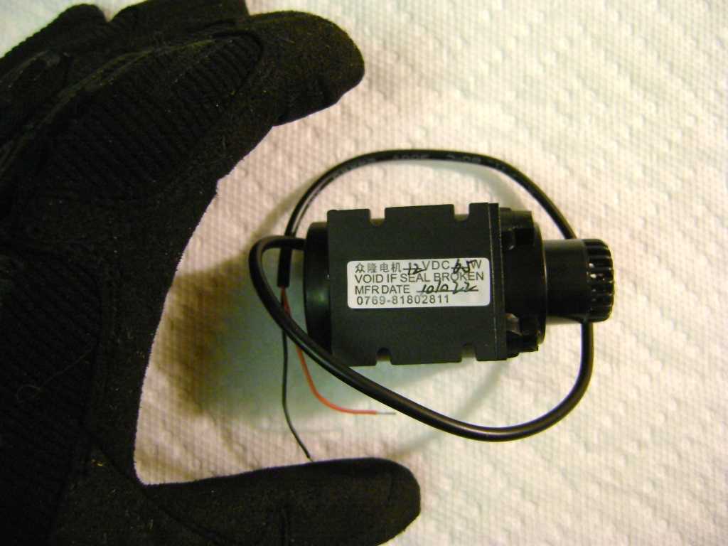

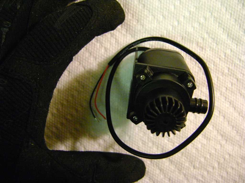

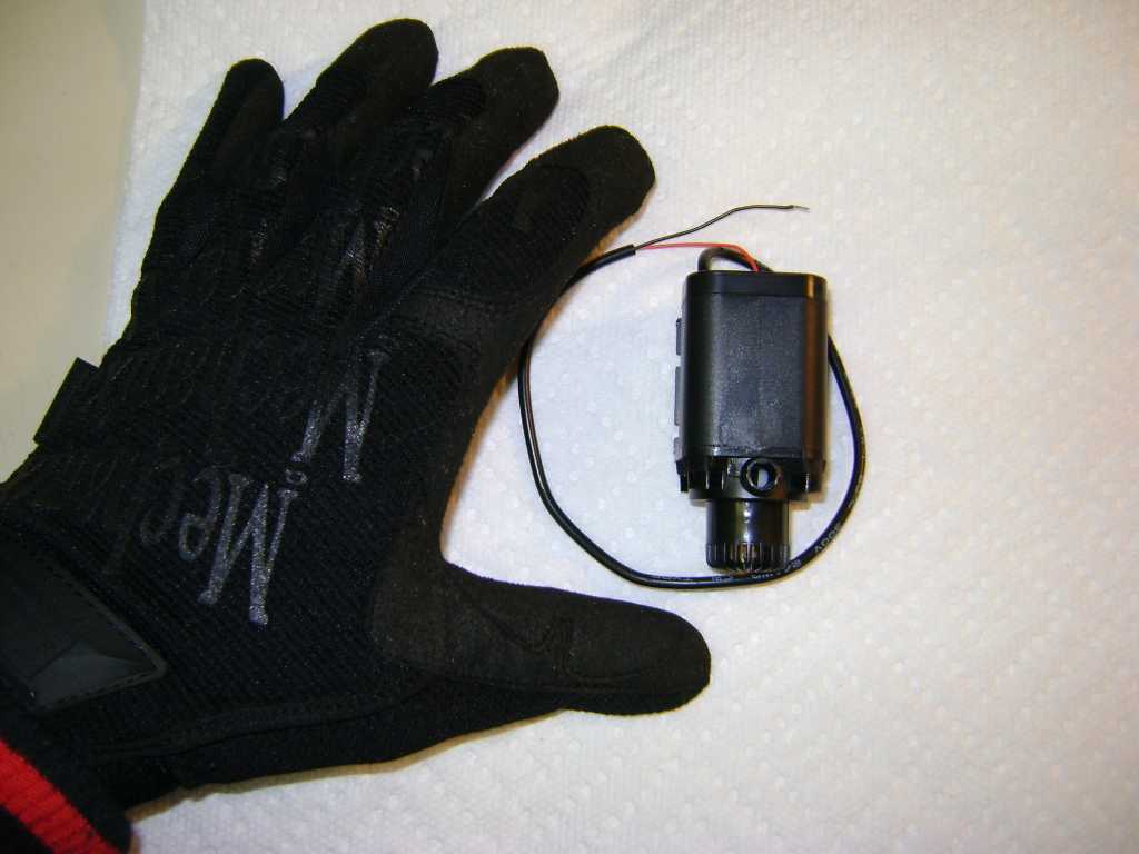

                  Gentleman...once again, your kind collaboration teaches me my craft. It is funny that in this situation, what you have guided in my thinking has prompted me to do the reverse of how I originally envisioned the base design of the first "FrankInjector Machine" where I had thought to create an elaborate electric pumping system involving an automotive fuel pump and some overly complex re-cycling and containment "aquarium". What it ended up using was the Aluminum container and the use of compressed air as the driving force to make it all work. But in this case, thanks to this early discussion, the reverse is true and I think that instead I will use a small electrically operated, inexpensive liquid pump:
                  http://cgi.ebay.com/3-8L-12V-CPU-CAR...item518c930960
                  Pocket-Rocket's idea about making a more direct fluid connection via the threaded oil filter interface makes more sense than trying to force many quarts of the special break-in oil through such a small and inconvenient orifice as the one fitted in the Oil Filter Manifold for the Oil Pressure Sensor Unit. Geoff Moore's (betterthanyou) suggestion about "The Bucket" prompted my search for a suitable, small liquid pump and the one linked above seems to meet all of the requirements, including working off of 12 VDC and having a 20,000 hour MTBF... all for less than $25.00.
                  The only other addition I will consider is that after having run this pump long enough to see the new lubrication percolating over the tops of the rocker arms, I intend to attach several powerful scavenged computer hard drive neodymium magnets to the outside and bottom of all oil filters, first to the initial "filled to the brim" camshaft break-in oil filter and then remove and replace them onto the second oil filter installed after the completion of the first 30 minutes of engine break-in time. That would all but eliminate the chance for any freshly machined areas and new parts from shedding ferrous metal particles and having the chance to become buried deep into the softer Babbitt bearing surfaces.
                  So all I will require in the way of materials for this project are:
                  1. A shorter length of the reinforced clear PVC tubing and some S/S screw clamps
                  2. The new fluid pump (the one I'm ordering works either with oil or water)
                  3. A threaded Oil Filter adapter to attach to the PVC tubing
                  4. Two leads and some large alligator clamps if a car battery is used (Or SuperDave & Robertisaar's idea for using an ATX Power Supply that worked out so well with "Frank")

                          To that end... when I receive the 25' length of reinforced clear PVC hose, I'll conduct an experiment by submerging this small pump in the bottom of a clean plastic bucket filled with 30 Wt Motor Oil and elevate the attached PVC hose to a height of around 10'. I'm thinking that if this "Little heart" can pump a vertical column of oil to that height... it should have no trouble pumping oil from the bottom of the V-6 engine block up, in and throughout the entire oiling system as well. If it struggles and labours along the way, then I'll know I'm on a Fool's Errand with the notion of using too small a pump and start a new search for a more robust one. I have not given up the idea that even if it has trouble performing, that I might simply elevate the bucket on top of a ladder and augment its fluid pumping pressure with a gravity assist, thereby helping to push the Break-In Oil down the tube and up inside the engine well below the level of the sourcing bucket. We'll see what happens. I'll shoot a video of this/these test(s) as soon as all the necessary components arrive. One other thought... the submerged fuel pumps used inside my F-Body cars are not much bigger than this little pump and they somehow manage to provide around 45 to 50 PSI to the fuel rails for years on end...and their design closely follows this one, right down to the application of a spark-free, brush-less commutator!

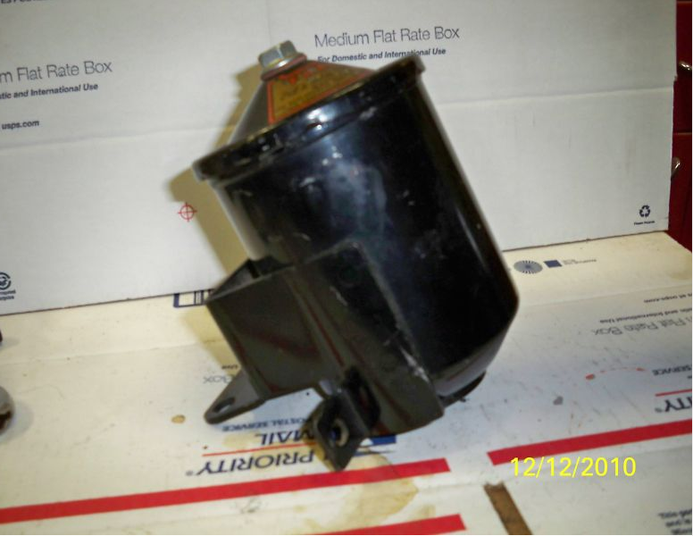

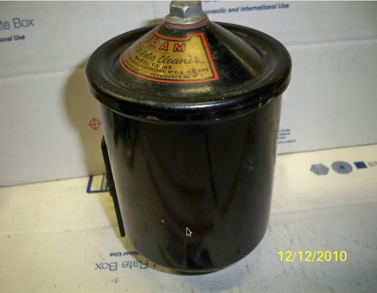

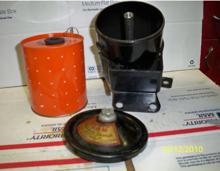

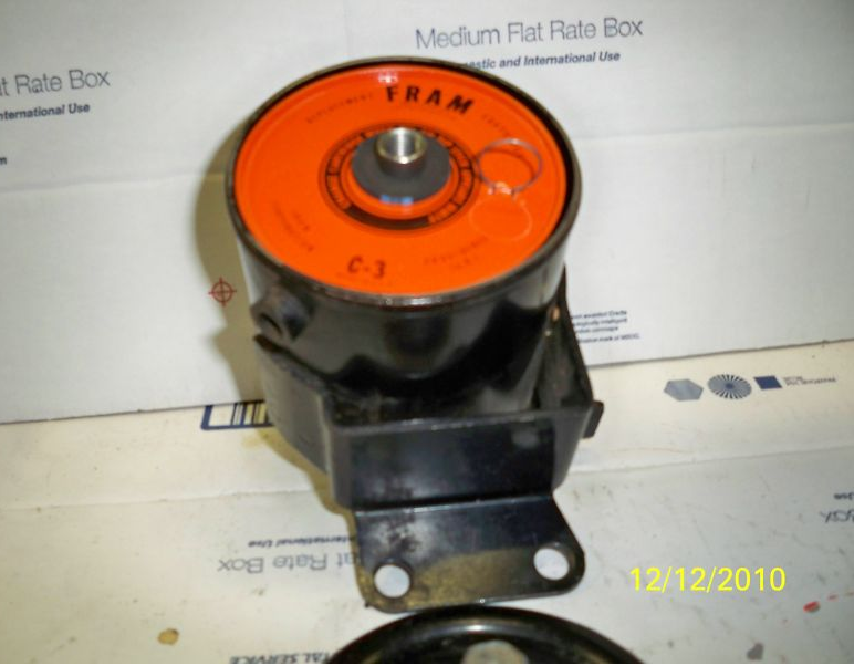

                              Okay... Following on with Geoff's "Bucket" Shop Pre-Oiler information and not wanting to tempt the Engine Break-In Gods by risking any dirt and metal contamination, I decided to include the use of an Old External Fram Cannister style Oil Filter unit to be interfaced between the "Mighty Heart" Electric Oil Pump sunk down deep in a bucket of Test Motor Oil with the long output line from the pump snaking into the in-flow side of the cannister style oil filter and then having the outflow line of a reasonable length attached to the base of a modified oil filter via the new Mobil1/Filter Adapter Plate.
                              To that end, I'll make this adapter by first slicing the base off of a BNIB Mobil1 Oil Filter and then braze a solid circular steel plate on top of it; pre-drilled and tapped of course, to accept a brazed on brass pipe nipple as the attachment point for the R&R Out-Flow hose. I think it wise to also slip a 3/4" Steel Hex Nut over the brass fitting/pipe and after centering it, braze it in place thoroughly so I have the means to tighten and loosen this Mobil1/Filter adapter plate onto the Oil Filter Manifold attached to the engine with ease, Doing this extra step will prevent me from accidentally snapping off the brass pipe connector during installation and removal because I can get a better feel of how snug the plate sealing rubber grommet should be to make it seal ...but without using too much torque. When it is done...I'll lay several small, flat Neodymium magnets around the outer perimeter of the round steel plate as extra protection to grab and hold from any stray metal mung that might be moved around and picked up in the oil stream from the incoming flow of the Pre-Oiler.
                              The only other consideration is to make certain that the incoming pressurized oil travels exclusively through the threaded pipe in the aluminium oil filter manifold at the block and cannot be diverted in any other direction or improperly routed through the bypass valve section of that manifold. If that happens, it would defeat the ability of being able to push enough oil under controlled pressure throughout the oil channels and coat the engine parts therein.
                              In theory ...all I will have to do then is thread the Mobil 1 Oil Filter/Plate centre hole onto the engine block where the normal oil filter would screw in and after a good snug tightening, then attach the reinforced clear PVC outflow hose to it with a S/S screw clamp. When I turn on the electric oil pump, I should be able to see the Pre-Oil/Fluid as it travels from the Oil Bucket ...into the Cannister-Style External Oil Filter...and then out the Out-Flow line and into the Engine Block via the new Mobil1/Filter Adapter Plate. Even at only 3.8L per minute...I should be able to determine if the oil has made its way through the block when I can see the break-in oil percolation out of the push-rods and down the valve train as a regular stream. I'm sure that by very slowly rotating the crankshaft just a few turns while it is being pressurized, the incoming oil will displace any trapped air and very effectively cover the inner surfaces of both the crankshaft and camshaft bearings. After a few minutes, this process should eliminate any dry galleries and allow the hydraulic tappets to sort of "plump up".
                              Naturally, I'll conduct the vertical pump test first as I previously suggested doing...with the added component of the External Cannister Oil Filter installed. If this "Mighty Heart" can pump the fluid to an elevation of 10 Feet...I'm confident it will properly pre-oil the engine. If this process shows any weakness in the necessary hydraulic pressure.. then I'll abandon the "Little...But NOT so Mighty Heart" of a pump if that scenario prevails and seek another 12 VDC electric oil pump with a more robust pumping capability.
                              Here are some images of this useful...but antique cannister unit.
