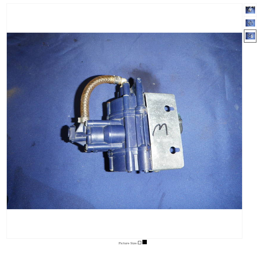

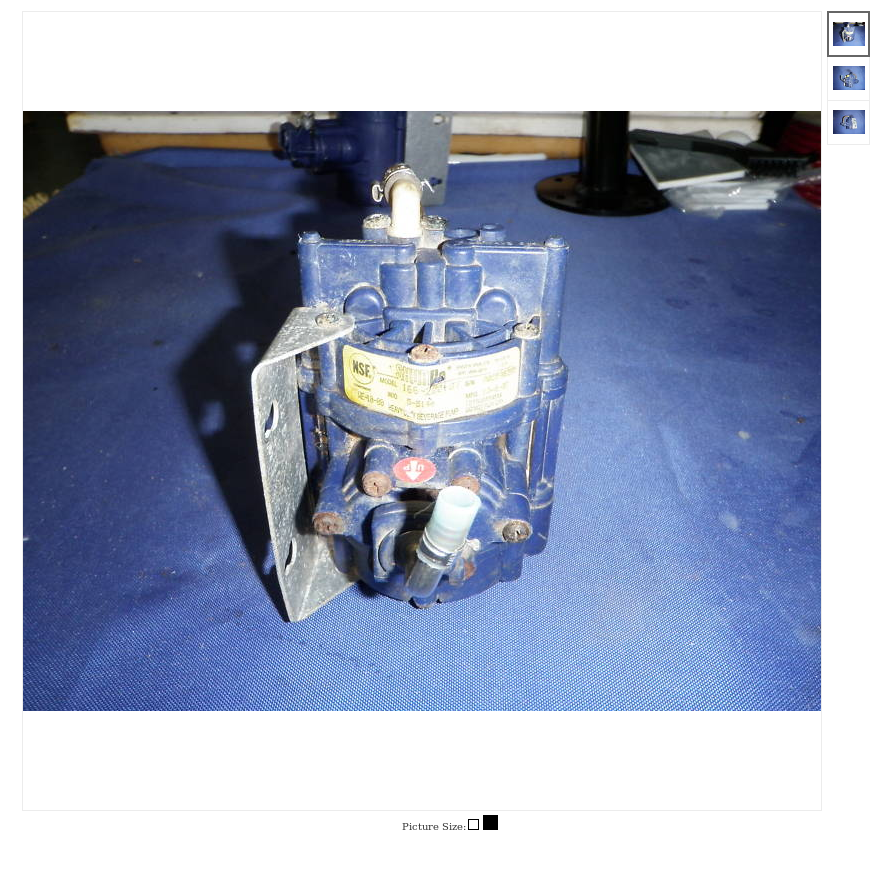

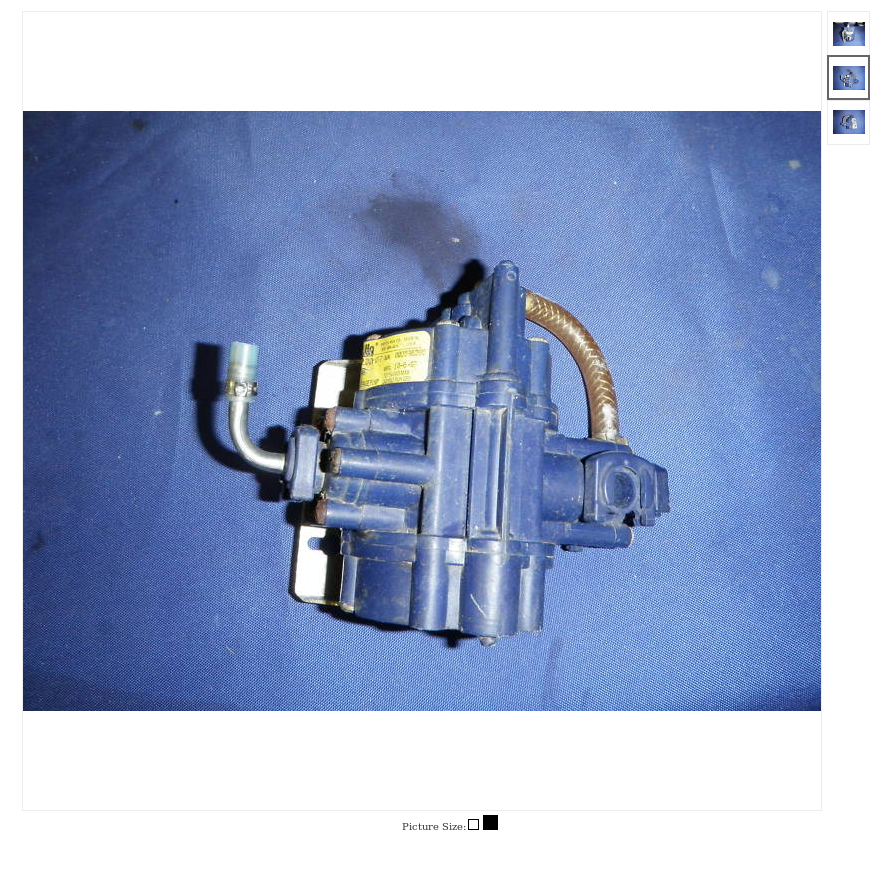

      P-R... Also... I forgot to mention that I spied one of those Shurflo Pneumatic Beverage Pumps on eBay as a "Make Offer" situation ...and forgot about placing the offer until this morning when I found out the Seller accepted my $10.00 bid. So I'll also be exploring the pneumatic driven pump design of the Oober-Loober as well. If you recall, I staggered through three iterations of "Frank" way back when and I see no reason not to try out this unit on the same machine...probably with both compressed air and via a 2000 PSI-Regulated tank of Dry Nitrogen I was using for HVAC copper tubing brazing line purges. Naturally, I want to take this pump apart to see what makes it tick before assembling a test bed for it. I was wondering if attaching a 3/8" fine thread plumbing "T" right at the FRAM C3 cannister would allow me to attach not only the braided clear PVC...but also an analogue Oil Pressure Gauge at a point where the maximum outflow oil pressure should probably be measured. I understand that over the distance the oil must travel down the PVC before it arrives at the Mobil Oil Filter Manifold, I can anticipate some loss of pressure, but at the very least.. I'll be able to measure what it is as close to the pumping force as possible. Here are some images of this used Shurflo Pump:

                  Damn, Jon... I feel so stupid... I wish I could have caught you B4 you spent the $$$... I was in ACE HW this morning in the furtherance of this project and was getting all the various brass plumbing parts I needed...when I spied another similar pump...albeit, with a slightly less GPM rating for just under $9.00 and I thought of your interest... anyway... the link to my photobucket will show how they compare with each other.
