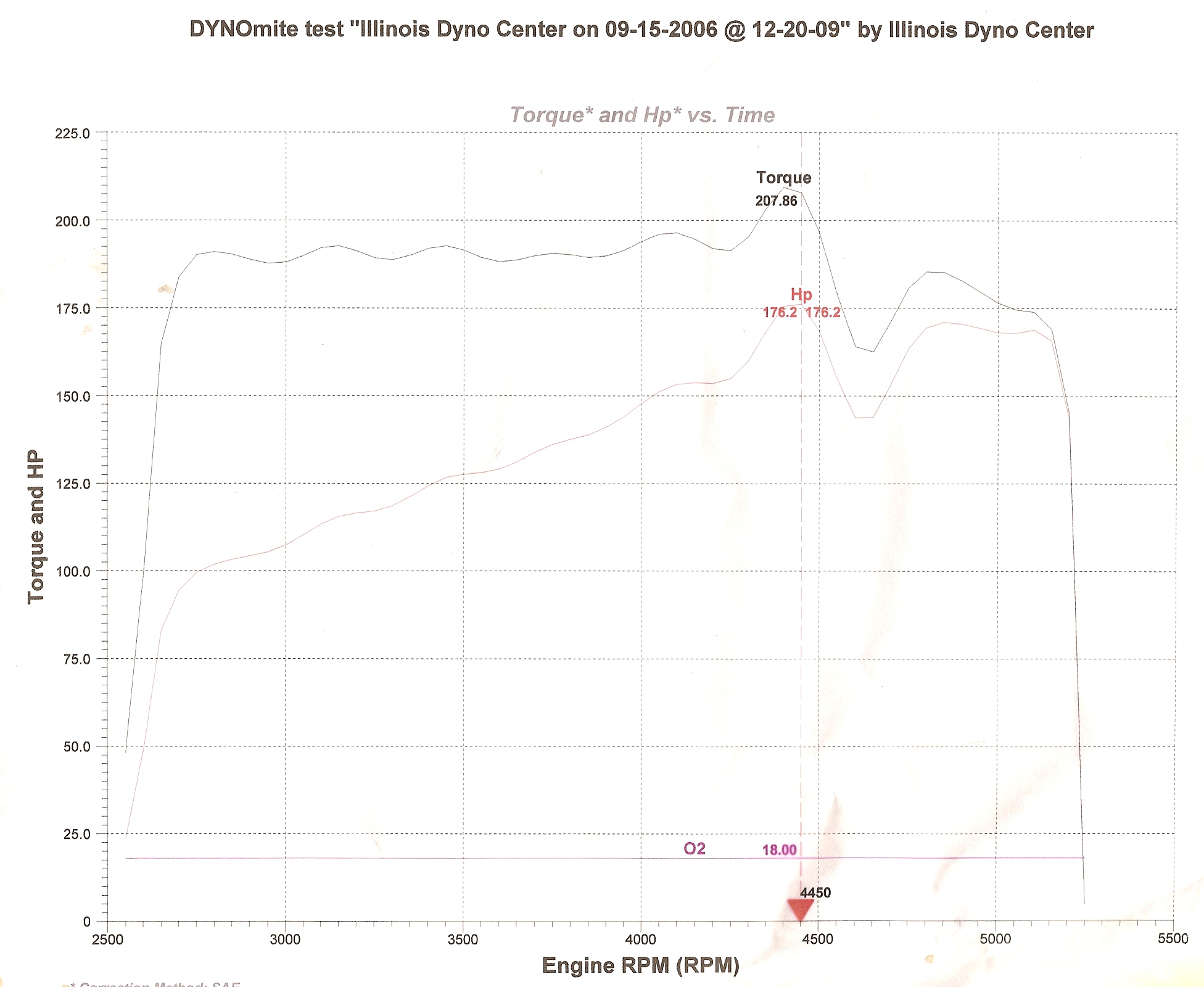

                        Whoops....*nearly bone stock*, only upgrade is an FFP underdrive and a CAI....at the V6z24 bash 88cavalierz24 did a 193 HP pull with FFP and a CAI and nearly the same for MrPaulo...
                        Brad91Z24 did a 180 HP with 220 torque with FFP, and 62 or 65 MM TB
                        We were all running chips made by Burn also..
                          • 13522
                          That doesn't add up IMO. pulley give 6 whp or so I think, and the CAI can't be worth 20+ whp. Did anyone dyno stock?
                              I was the closest to stock...stock air intake with just the underdrive, had the Multec 2s also. No VSS so that may have messed up some values and i also had a slight bog at lower RPMS...
                              here's my dyno sheet. Here is a link to the other bash dynos
                              Since I'm local this is easy. :) We had some really strong dyno pulls today. Some may shock you! Post your car, power mods, and output. 04 Cavy RK Sport intake, Magnaflow CAT-back Peak HP 148 @ 6050 Peak TQ 144 @ 4350 Stock HP is supposed to be 140hp at crank. Talking to the guy there he...
