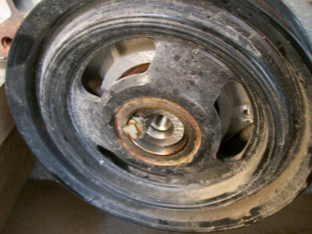

      Ben, you said thread into the pulley.... unless you mean thread into the center I have nothing else to thread into.
      Seems like whatever I use needs to have 3 arms with L brackets that go and somehow lock behind each of the 3 sections of the wheel, then the center of the arms screws into the center and it forces the pulley off.
      I told autozone what I needed (for renting) and they had no clue what to give me, eventually they handed me the harmonic puller.

          Interesting, as that is not like the old 3x00 style pulley. The old style had a threaded hole in each arm. The harmonic balancer puller should be able to do the trick though.
          • Guest
            #65
            Not without making some adaptors.
            The Harmonic balancer puller is designed for balancers that have threaded holes to use bolts to attach each part to.
            A 3 jaw puller, with the jaws behind each cutout and some sort of die in the middle to keep the puller from pushing into the crank, much like what the balancer puller would have would work.
            I bet Snap-On and Mac have tools designed just for this very application, as well as the couple other engines I've seen with similar pulleys/balancers.
              #66
              I used a 3 jaw puller to get my 3500 pully off, worked perfect.

                I'll use my old one if it's easier to get on/off later.
                Thanks, I'll go hunt down a 3 jaw puller today!

                  I used the regular bolt in style except I put washers behind the spokes and put the bolts through them and held them in place with washers which actually did the pulling. A little heat, just a little would help also. I couldn't find the third arm to my claw style puller.
                  The 3500 balancer is also a little larger in diameter so installing the 3400 pulley will give you a little under drive.

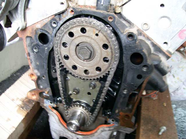

                    OK I got the crank pulley off with a nice 3 jaw puller. Now I got the timing cover off.
                    Here is where I am unsure of what happens next. I think stick something through a hole in the top gear here and torque the bolt in the center off. I have no idea what is under that, or how the cam comes out of there. I know I gotta pull the push rods out of the valve covers... will the lifters be attached to them or do the lifters come out a different way?
                    Just wanna ensure I am doing things right since I have no one else to ask, and I don't wanna take apart stuff I don't need to!

                      I usually block the flywheel to get it loose. Nothing will fly off from behind the gear.
                      What do the numbers on the end of your crank read.

                            To get the lifters out, you will need to unbolt the lifter retainers from the block (under the LIM). Sometimes the lifters will stay with the retainer and come out that way. Otherwise, you just have to grab them or use a magnet to get them out.
                            Oh, and case you didn't know, or you haven't seen it on the site before, remember to keep the pushrods in the correct order.

                                OK I see that the LIM has to come off now to get to the lifters, I was trying to leave it on...
                                Can the LIM gasket and everything be reused? I know they added those little guides so you don't have to RTV the bottom of the LIM, but if I'm careful will it all be reused?
