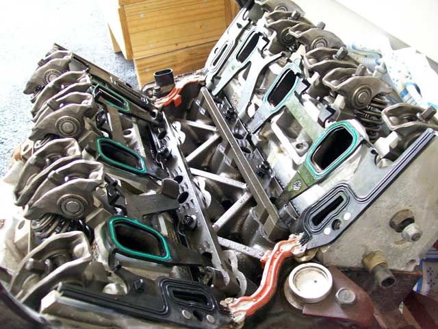

    OK just got everything out (aside from the cam it's self), some of the LIM gasket is RTV'ed to the block and such and they were also RTV'ed to the valve cover gaskets, had to break em. The gasket looks OK to reuse, but one of the orange seats ripped apart
    Anyways I took the little cover for the cam off, and I pull the cam and it comes about half of an inch and stops, you hear it hit something. I ensure I left no rollers in there and try again, same thing. Does the oil pump drive need to come out or is there something else holding it?
    Also does anyone have torque specs for the 3500 for when I put this thing back together? Or are they the same as the 3400/3100?

      Oil pump drive has to be removed first as the gear on it is meshed with your cam gear. Not sure but the specs are probably the same.
        #78
        never re-use LIM gaskets.

              Does that have the little orange channels too for the bottom of the LIM? One of mine ripped apart when I pulled the LIM off.
              Everything is so nice and clean, I hate to have to throw these away.
              Edit - btw what is that plug for in pic #1?

                Cam Position Sensor
                Since that is a GM PN, then yes, it will have the orange channel gasket.

                    You might be able to get away with using the LIM gasket again since they are so new. Depends how smashed it was. You could and then check it ever so often for vacuum and coolant leaks and make sure to do that regularly so if it does leak it doesn't trash the motor. The orange side things are used instead of lots of silicone. You could do it the old way with just silicone probably.
                    That plug is the cam position sensor. They changed from a pigtail to putting the connector right on the sensor.
                    The CPS is the 7x one that you have to put for the external CPS. It's located in the back of the block and is the tube shaped one. (pull the one from the 3100 or get a new one, but don't buy autozone ones, they are junk).
                    The 24x is the horseshoe shaped one that you'll swap over with your crank pulley and timing cover from the 3100.
