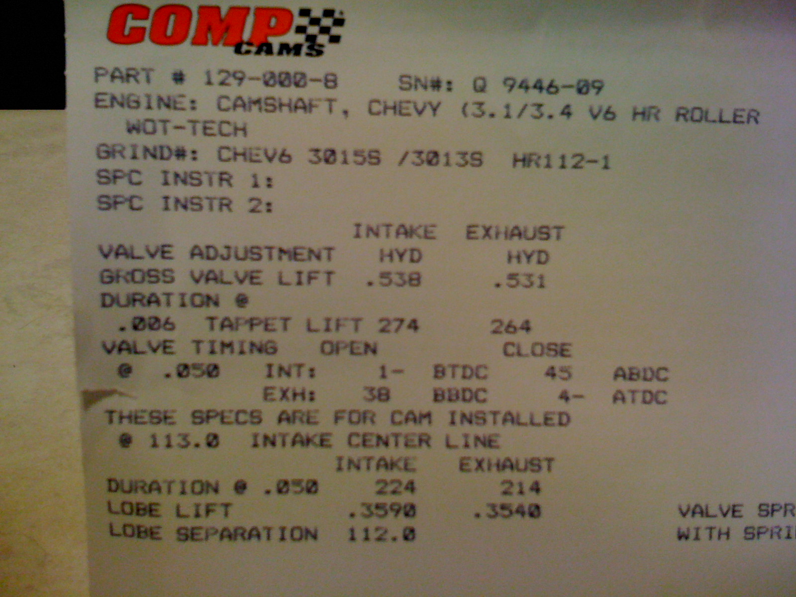

                            My 3900 with cam and springs did a 13.3 with an automatic at 103mph. With the 4 speed manual it did 13.4 at 106mph. I'm switching to the F23 with the hopes of clearing up my shifting issues. I've been told that my cam leaves a lot on the table so you may do better. Good luck.
                              what were your cam specs?

                                You'll have to adjust for the 1.7 rockers. This is for 1.5's.
