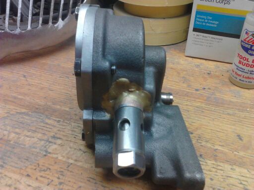

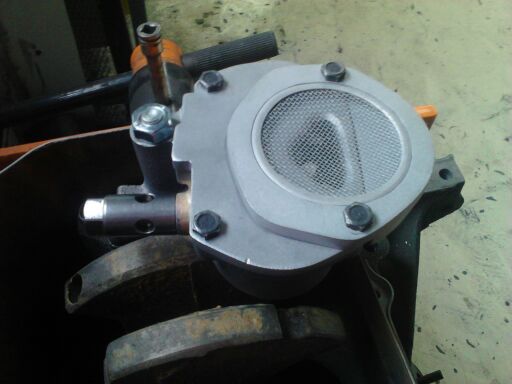

ID:	377336 This is a 3900 oil pump modified to have the intake on the bottom and the by pass valve external. This allowed me to build a shallow pan for my track roadster. The pan is approx 17" long X 12" wide X 5 1/2" deep and oil is 1 3/4" deep in the pan, giving me about 7 quart capacity. It will have trap doors for oil slosh control as well as a crank scraper and windage tray.

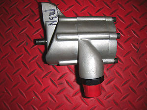

          Seems like you got quite the plan. You said something about having a some sort of internal pump that acted like a dry-sump. Got any pics? I've never heard of anything like that.

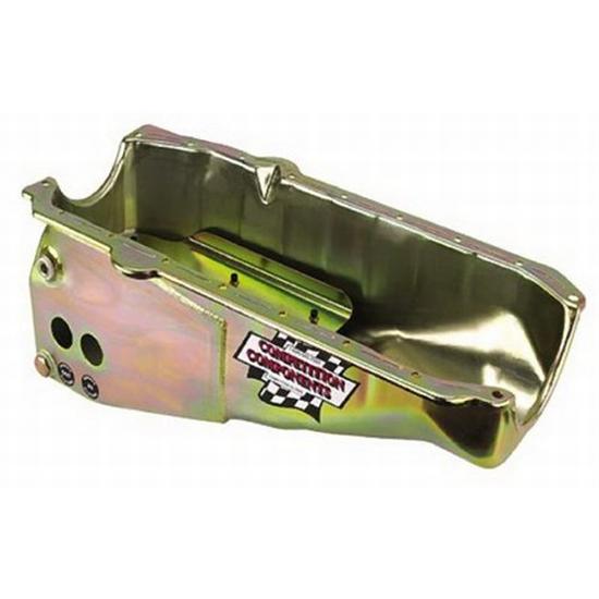

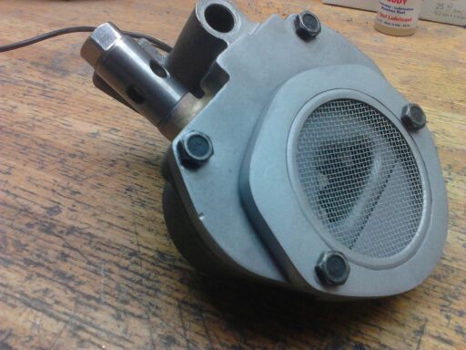

            The Barnes small block chevrolet internal dry sump pump that several sprint car engine builders used in the late 70's and thru the Click image for larger version
ID:	377343Click image for larger version
ID:	37734480's was pretty much a pump with two sets of gears, with one set stacked on on top of the other seperated by a plate. These gears were driven of the cam/magneto by a hex shaft. The lower set of gears scavenged oil out of the pan and sent it through a -12 fitting out the side of the pan to a remote mounted tank, the other set of gears pulled oil from this remote tank and returned it to the oil galleys in the engine.
