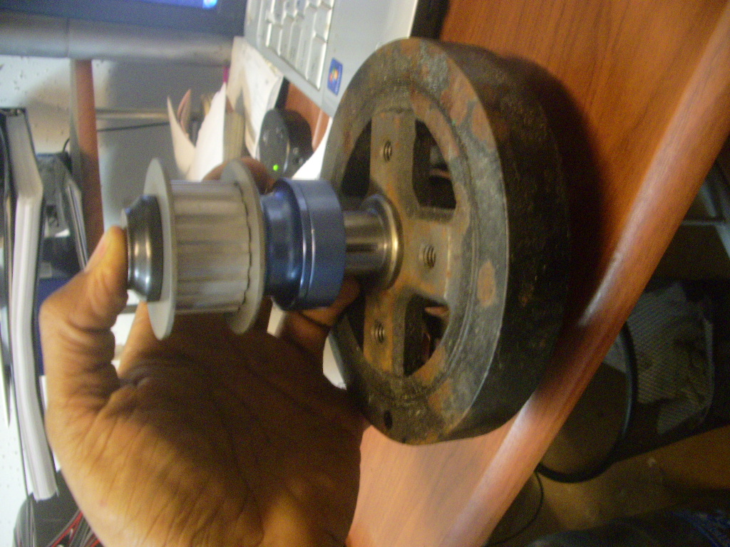

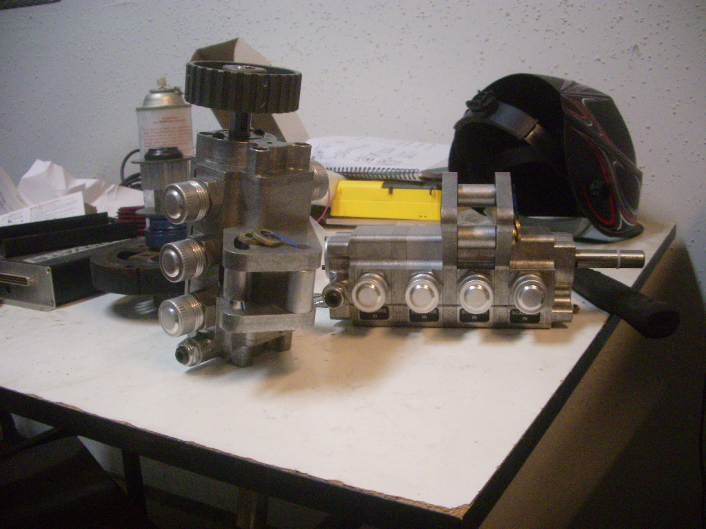

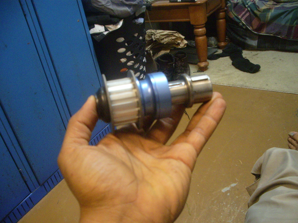

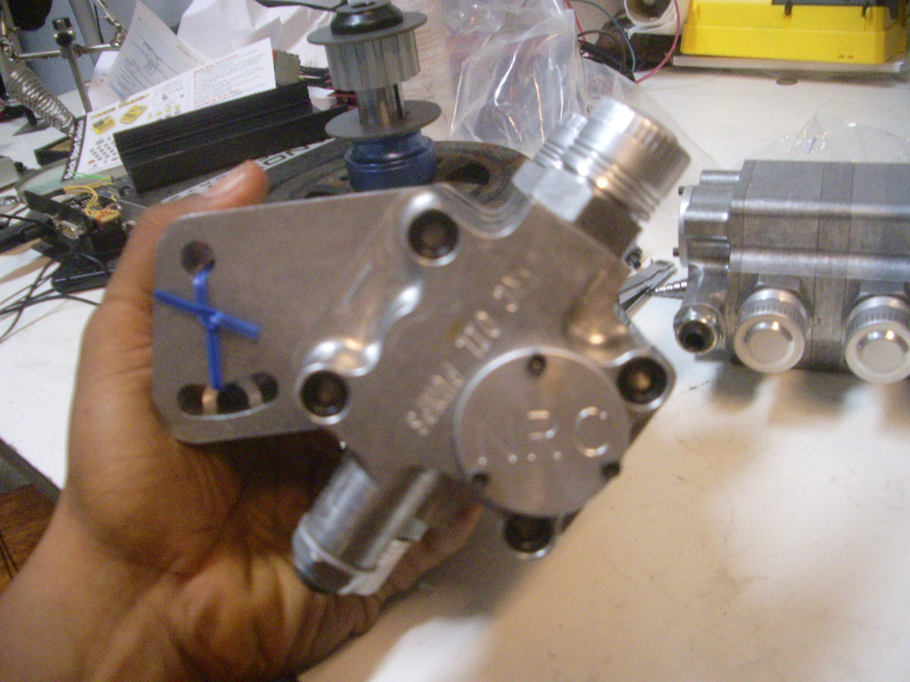

                              If your gonna modify an oil-pan then what about going with a dry-sump pump? NRC (nutter racing engines) sells brand new, "in-house", american made, CNC pumps for an affordable price. You can get a 3-stage pump with cog pulley and mandrell to fit the 660 for $588 shipped w/ 0ne year warranty.
                              Their 4-stage pumps are about $100 extra. Try buying the same thing from Moroso or Barnes and you'll spend $1800 for the pump alone.
