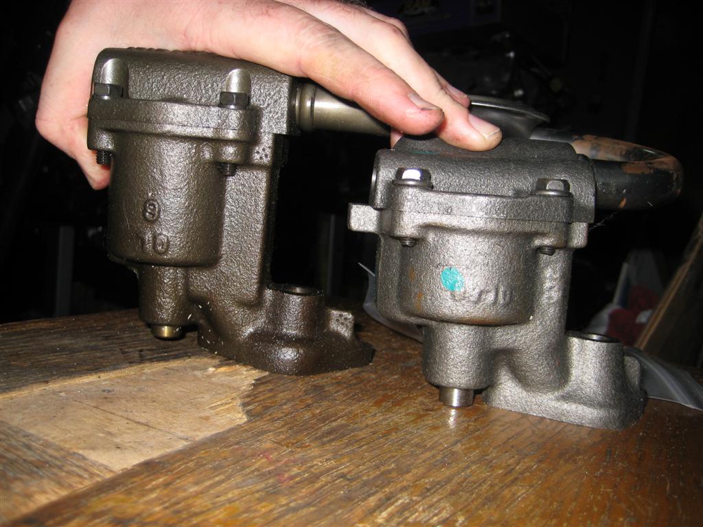

    (pics) 3900 and 3500 oilpump comparison
    Since Im modifying my 3500 for oil-jets on all 6 cylinders, I was needing a pump with an adaquate flow rate.
    After a lot of searching I believe that Ive found candidate for an oil-pump. The 3900 uses oil-jets stock so the pump will have the flow that I require. Here are some pics comparing the two...
    Heres pics of the 3900 from the top (flange side)
    Heres some pics of the 3500 from the same angle
    Heres some pics of both from a side profile. Youll notice that the 3900 oilpump is a bit shorter. Im not sure how that will affect install on a 3500 block
    And heres a couple more to compare pump size

    Not to be an ass or anything, but those are photos off of my LZE 3500VVT motor not the 3900. I am fairly sure they would be the same, but just so you know. Again not trying to bust your balls or anything like that.

      Oh, not at all man. In fact, your the one that posted those same pics after I posted a thread asking for them. Im able to post my findings because of your help.
      Id like to thank you again for that.
      (LZE VVT3500...got it)

        A 3.4 DOHC pump would also work and probably has a lot more flow than either of those. I don't know how much you would need. The 3500/3900 VVT should be enough.

          Since Im having my block machined to accept oil-jets, Id imagine that the vvt3500 would have an adaquate pump since it comes "stock" supporting oil jets across all cylinders.
          Do you have any pics of the 3.4l DOHC oilpump by any chance? I thought that block revisions to the 3500 made them incompatable with older style pumps.

            The 3500 is the same as the 3400 as far as oil pump looks. The 3.4 DOHC is a bigger version of that. I will get some pics in a sec.
              • 13530
              Sorry for the delay. I think you know which is which:P
