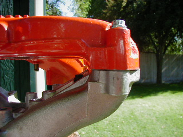

                      Oh and I'm not saying the stock intakes are good, but they aren't terrible
                      to this, I dissagee 110%, a 300* bend in an intake manifold like that is never good.

                            #178
                            the owner claimed it made a huge improvement, but I don't remember anything measurable.
                            [ATTACH=CONFIG]5530[/ATTACH]
                            I'ts a 180* bend, not 300....the problem is more the sharpness of it and the small ports, 3x00s make the bend/transition much more smoothly

                              #179
                              whoops you're right, I'm using new math...
                              the 3x00 intakes also eliminate more than half of the runner, have much more plenum, and larger ports.

                                #180
                                did I mention the neck that leads to the plenum is super tiny too?
