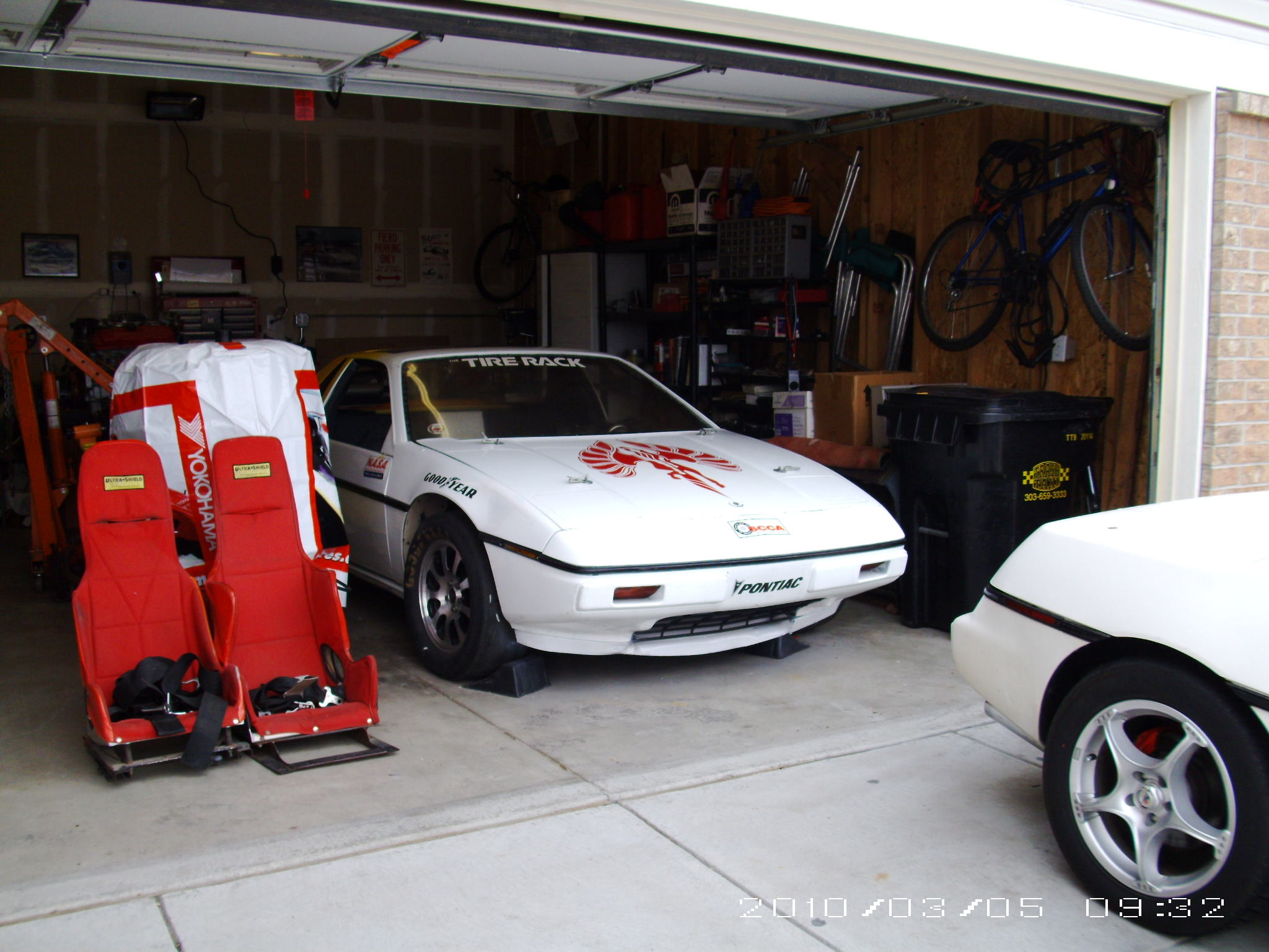

                Here is a "teaser" photo of the car sitting in my garage. The Fiero in the drive is my street machine, and Cadillac powered.

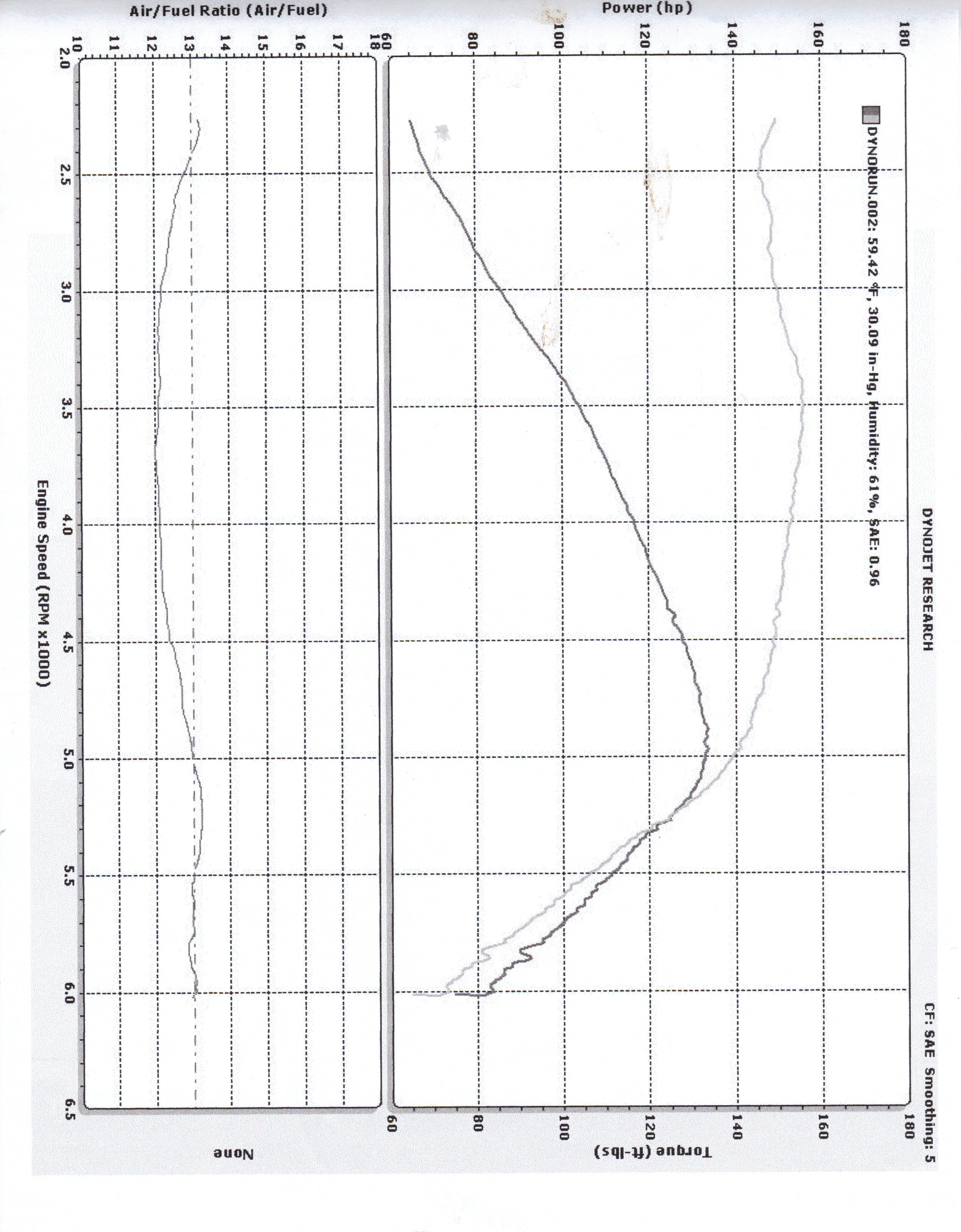

                            Even with the restrictive Fiero intake and stock exhaust and stock chip/tuning, this 2.8 engine produced some degree of power. This engine just can't breathe, and should do a lot better (especially with that cam). Here is the chassis dyno sheet, note the low air/fuel ratio.
                            With the headers I am building and any kind of better breathing - from the carb to the 4.3/5.0 TBI to the 3100 heads and intake we are discussing (any one of them) - there would be a vast improvement. From what I can see, the 3100 should be the best breathing choice of the bunch. I would expect with a fuel/air ratio of around 12:1 and with better exhaust (along with some creative tuning) this engine should peak at around 180- 200hp and over 200lbft torque according to an engine calculator. One set of figures has it at 221/228 (with 13.5 CR).
                            Keep in mind that this is powering a 1950lb car (2100 with roll cage).
