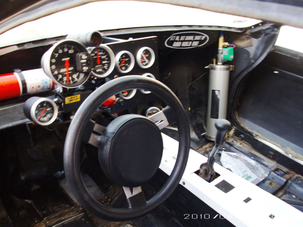

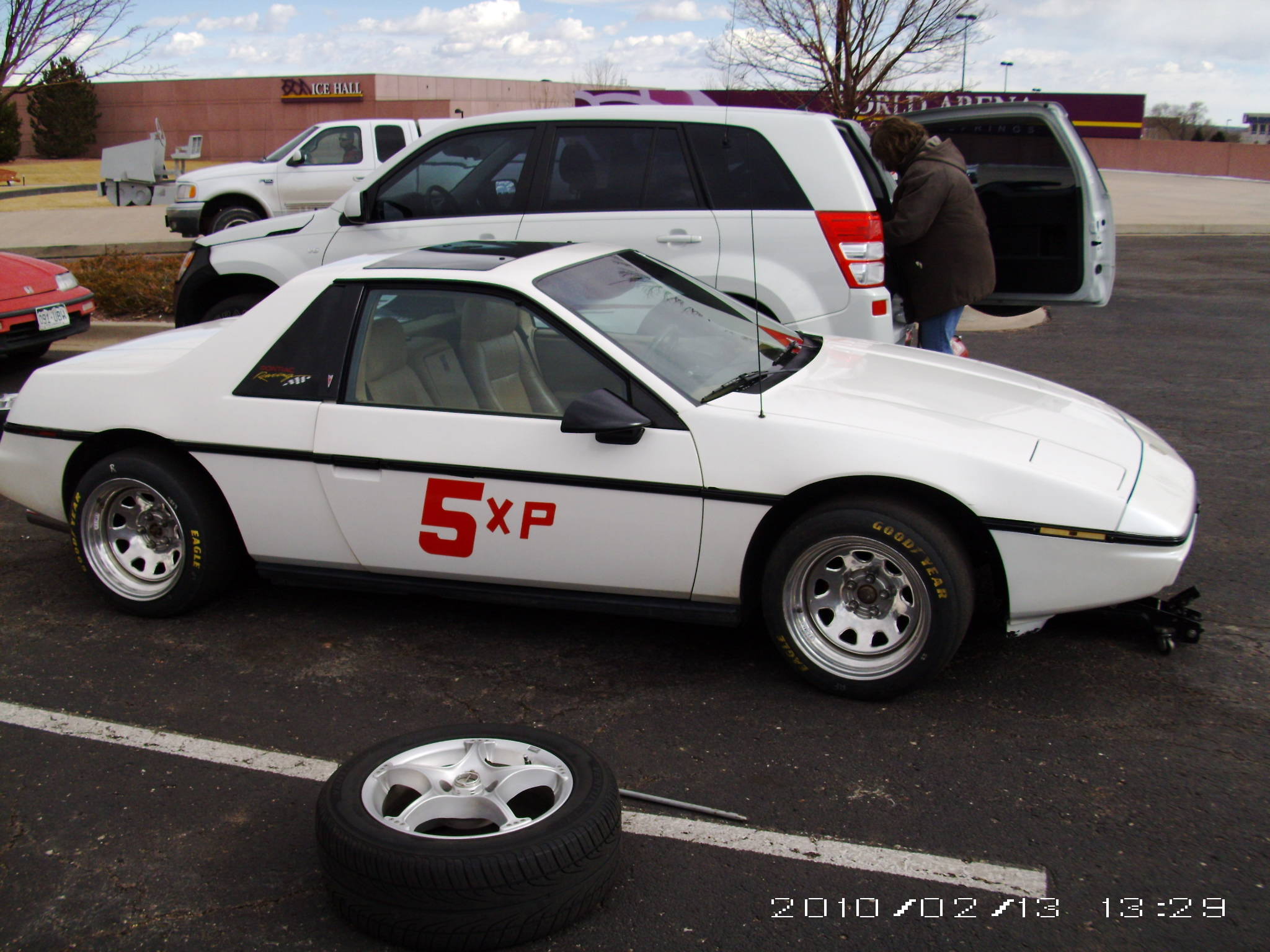

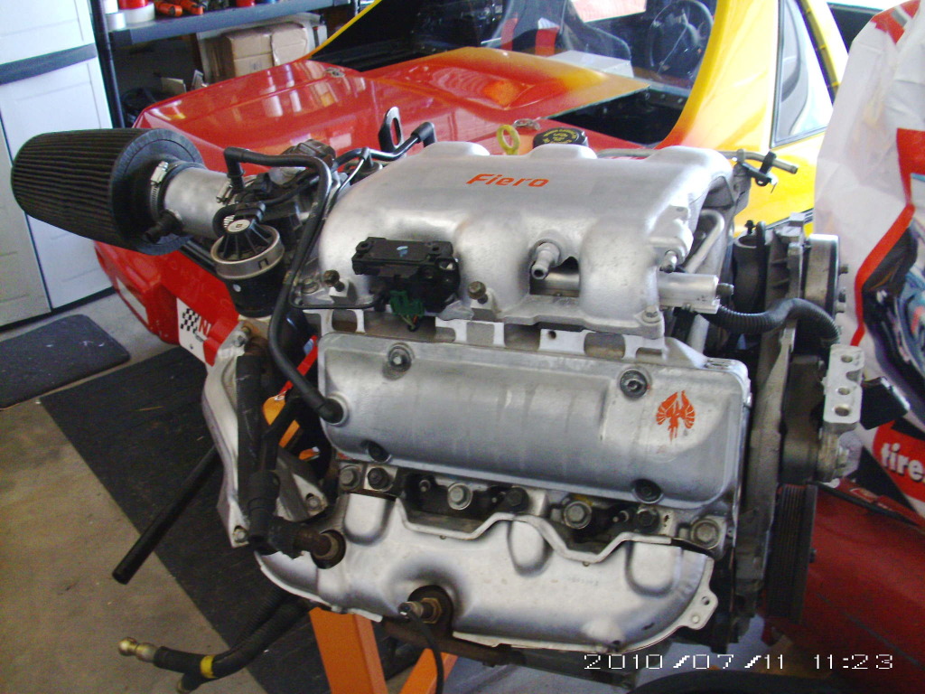

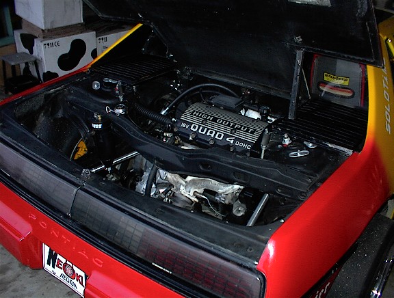

                  A picture of the racecar with the Quad 4 (taken in 1997) and of the "dash" of the Pegasus Motorsports car. The third photo is of the "2800" engine, still in progress. I will send photos of the entire car as soon as I get it back from the shop that is installing and welding the cage. The third photo is of the Caddy powered daily driver at a local SCCA ax last February, just for grins.
                  The "2800" engine hasn't been installed yet. It started as a stock 2001 engine with bad rods and crank (and badly sludged up with signs of overheating). We rebuilt it using a reground 89 2.8 (DIS aluminum head) cam kit and rods, This photo was taken before the DIS module with Accel Super Coils and the front end from a Fiero (double timing chain with only the alternator and short shaft water pump and pulleys) were installed. We are currently swapping computers and wiring harnesses before installing this engine. After I get the "real" race motor built up with the wild cam, and using the WOT heads and intake as discussed earlier it will be an easy one day swap to replace this motor with the "real" race engine . . .

                      The Quad 4 was the first of many multi-valve 4 cylinder engines, very "primitive", loud, rough - but fast (for it's time). The beauty of this powerplant is that it was light and could easily produce more than 100hp per liter. In the road racing version it produced 270hp+ from 2.3L. What it didn't have is a lot of torque, and being a multi-valve engine it required a lot of RPM, the power curve came on at around 3000RPM and wrapped to about 6500RPM where it dropped off. (I de-tuned my Rocketparts engine to 237hp which brought the torque up to 208 by doing so. Adding torque - even at the expense of horsepower - made the engine more drivable between the cones. (In autocross, torque is more useful than horsepower, as I am sure you know).
                      When we were putting this car together initially in the early 90's, the Olds Calais was killing cars in it's class with the Rocketparts Quad 4. We had the Fiero stripped to just over 1900lbs with this engine and a full 6 point cage (the Q4 long block was less than 200lbs). And that made the car very fun to drive - but not competitive in E-Mod. You are looking at the likes of Tamandli's 1600lb tube frame, Rover racing V8 powered Fiero, or Turners 1600lb tube framed 600hp/600lbft Triumph TR8, or more recently his JDM racing rotary powered 1600lb Miata for competition. The Q4 was fun to drive - yes. But competitive in E-Mod?? Not hardly. That's why when it became illegal in Prepared for the 2000 season I moved on. So I guess I would need to know more about what you want to do with your car, such things as whether it will be a dual purpose (street and weekend racer) Fiero, or just how you plan to use it. But keep in mind that my current choice for a powerplant is NOT the Q4 but the more torquey 60 degree V6 . . .
