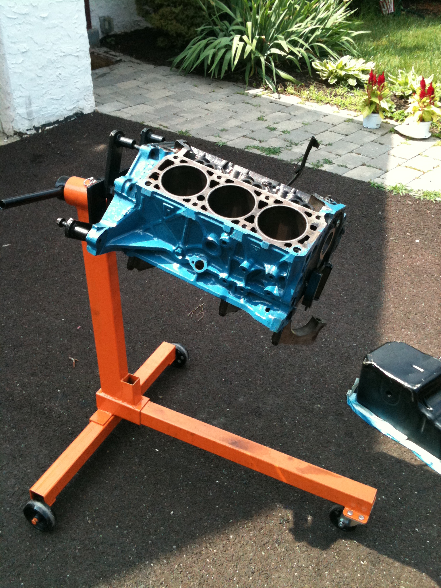

    Starting my engine build.
    I got a free 3.4 shortblock and 4l60 from my tech school, block said to only have about 10 to 20 miles on them. The car was donated new then stripped to pieces. I plan for a 3.4/3400 hybrid motor. Im gonna keep the 3.4 pistons so its gonna be high compression.
    The stuff I plan to use:
    ARP main studs : http://wot-tech.com/shop/gm-60v6/mai...t/prod_91.html
    ARP Rod bolts : http://wot-tech.com/shop/gm-60v6/arp...s/prod_31.html
    ARP head studs : http://wot-tech.com/shop/gm-60v6/arp...t/prod_69.html
    Chevite main bearing: http://wot-tech.com/shop/gm-60v6/tri.../prod_267.html
    Chevite rod bearings : http://wot-tech.com/shop/gm-60v6/tri.../prod_266.html
    272H cam
    Now The stuff I need help with, What thickness head gasket should I use?
    And also what size pushrods will I need?
