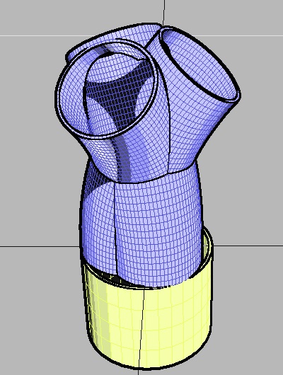

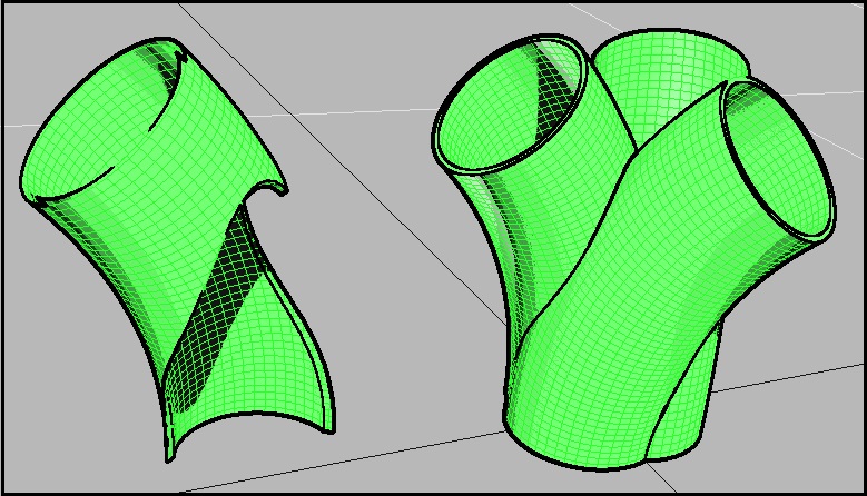

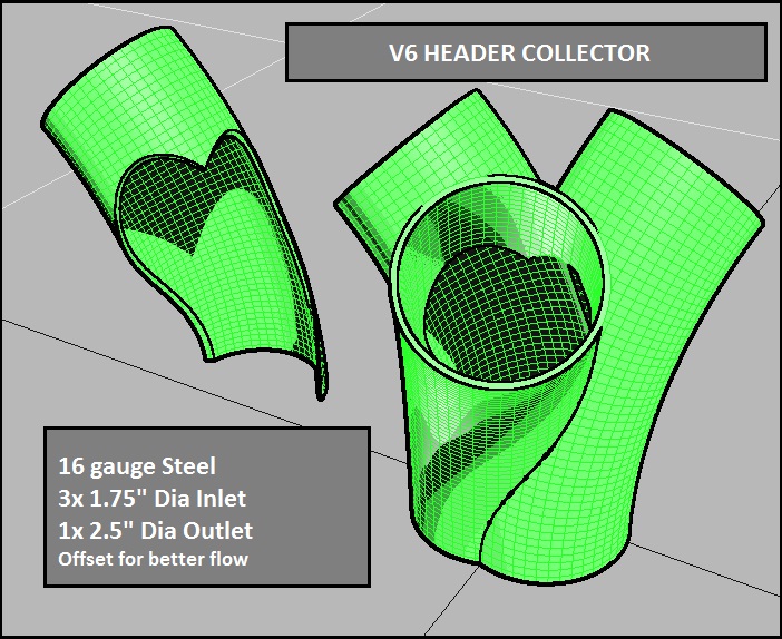

    Here are a few teaser diagrams of my new v6 header collectors. When I decide to weld up the turbo headers, currently stuck with the stock logs.

    Made in Studio Max. The idea is no open turbulant area in the center and each pipe directs its exhaust pulse at a slight offset. This means the previous pulse will be less of a restriction and a vortex should be created.

    I don't know if that is what will happen though unless you have equal length primaries, and even then you want the smoothest transition possible for each pulse to retain its strength. The speed of the exhaust vs the length of the primaries will determine when if ever that vortex could be created.

        True merge 3-1 will naturally create a "vortex". I don't know if over-engineering would benefit here, there's a reason Burns collectors are consistently winning races.
          I'd do some small scale testing on that design well before trying to cut that out of some steel tubing, building a test rig to accurately see what's going on will be a major undertaking though.

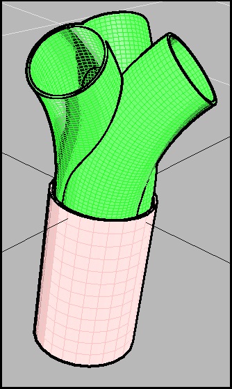

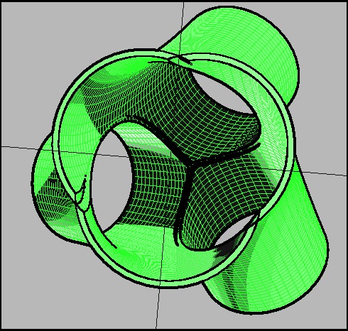

                It does take some work, cutting the steel. But I did make a molding around the bend which can be cut with razor. I'll transfer the template on screen to the paper molds (I have an unwrap printed out but it is messy). Once the paper molds, which are pretty strong, are cut to shape just right, then they slide on the steel nice and tight. A quick blast with spray paint to mark the cut-out area hit it with the cutters.
                I have a rotary cutter that can slice this steel fairly well.
                Weld it up and then just clean up the insides like any port job.
                Part of the offset in the design is for a reason. 1-3-5 or 5-3-1 will change how the next primary interacts with the previous primary. So I'm not sure which way yet, CW or CCW. But one way places the exhaust pulse much closer to the previous pulse in a tighter spiral. The other way places the next pulse further away in a more open spiral. Not sure which way would be better.
                Also, there 'should' be a negative pressure wave created in the other two pipes as the blast is pulsed out the one.
                But then it dawned on me, for velocity and other special dynamics, the blending of all 3 should meet in a spot of similar diameter to flow 1 pipe, not 3. The negative pressure wave created in the other 2 would be stronger.
                So I need to flow test two different ideas, but wow, flow testing a pulsing exhaust is going to be rough. Can't just push air through all 3 at once.

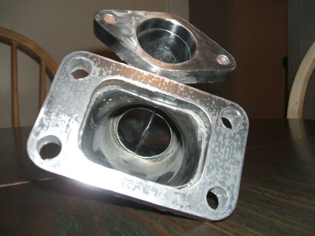

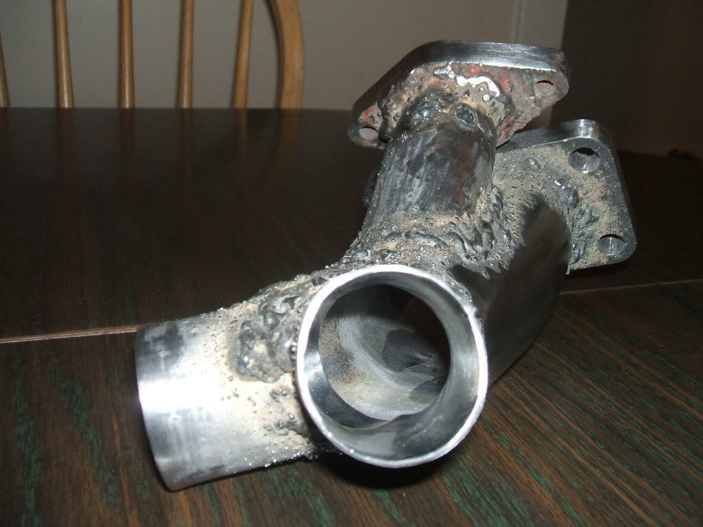

                              Oh yeah, I used a dremel to cut the steel pipe for my turbo manifold, then used a sand roll to make the ID just right. Merging 2 pipes smoothly is much easier then 3. It took some time but it was worth it.
ID:	376807Click image for larger version
                              The turbo manifold wasn't fully welded in these pics, but it shows how anal I am about the boundary where the two meet, I spent a while grinding smooth and polished it.
                              I determined few things before I started to build this engine up, optimize intake and exhaust as best as possible was one of them. The exhaust post-turbo is done and the entire length has zero interference along the way (within reason). The exhaust is wide open and the only resistance is the dual flowmaster 40's.
