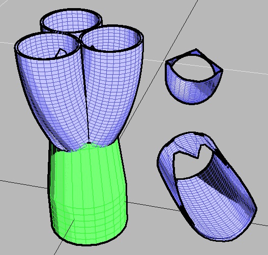

      I decided to try a different, less intensive approach. And it just so happened to be just like the pics ForcedFirebird posted.
      And it will be easier to pipe together since the 3 inlets are lined up side by side.
Name:	v6 collector reverse merge.jpg
      My theory, atm, is to take a tried and true method described above. Then attempt to achieve perfection in measurements, cuts, blending, polishing, etc.
      The nice part about this style is the ease of cutting. It is a straight line cut from above.
      I heard once the header is ineffective with turbochargers. Is this true? It seems the impulse from the opening valve should still create a reversion wave at the collector regardless if there is a turbine down stream or not. Unless I am wrong....
        [ATTACH=CONFIG]6056[/ATTACH]
        why are you knecking down the collector then bringing it back to a full sized pipe diameter? At least it looks that way. I know on NA applications this is done to produce an effect, but on a turbo app this will actually hurt gas velocity as it enters the turbo. you want to come out of the collectors into either smaller piping or same size piping as the outlet at the collector. enlarging it i would think would have a negative effect on velocity.
              Thank you, this is exactly why I post here. I have a lot to learn yet, but I am on my way.
              I am taking your advise and removing the taper. I thought it was for velocity but didn't realize the difference in turbo apps. Speaking of the collector, I still yet have to find the idea diameter for the primaries. Also need to figure the cross-sectional ratio from 3 smaller pipes to one larger pipe. Should I maintain equal cross section area?
              Example,
              Using 16 gauge as the example (roughly 0.0625" or 1/16" thick)
              Primaries, 1.75" OD / 1.7375" ID
              Surface Area of Circle = 2.37"²
              Three Primaries Total = 7.11"²
              Secondary Pipe Diameter = 3" (which is A= 7.11"²)
              But if I go 1.5" Primaries then the secondary should be (1.767"² * 3 = 5.3"²) diameter of 2.6" ID , 2.725" OD.
              But it seems excessive to have two 3" pipes merging into the Turbo. But that is how the math states it.
              Any advise there?
              EDIT UPDATE: I think I am missing pressure as a factor and that all 3 exhaust primaries aren't flowing at once. So I think I should approach the equation with mass instead of volume. And then knowing the average ambient pressure in the header primary while valve closed and when there is flow. So then the secondary pipe should flow (2x ambient PSI + 1x boosted exhaust PSI ) = secondary diameter to maintain steady velocity for a given PSI during 1 primary flowing. Ugh, thats gonna be a cruncher. I need to read up on my physics books I have lying around.
                Example,
                Any advise there?
                Here is the big question, Why do people say the header won't work the same on a turbo?
                I know it seems like a silly question but if the scavenging effect is created at the collector, then in theory exhaust under pressure would still create a lesser pressure reversion wave which would aid the excavation of exhaust gases under greater pressures and heat. Same mechanics just at a higher pressure with greater heat. But what of the turbines effect on all of that?
                ideal primary size honestly will just match port size. we use 1-5/8ths primary runners, they fit the port size and inside the flanges we had designed. smaller will work on lower boost setups, i am not against 1.5" primary runners. We used 1.5" on our turbo mustang kits for the most part and those guys where consistently pushing 550whp. of course a ford 302 has silly small exhaust ports.
                honestly you could build your kit using 1.5" runners and 2" crossover pipes and make as much power as you want. we use 1-5/8ths and 2.5" crossover pipes, the reason is that with our pressed collectors that is the outlet size of the collector. There is no need for 3" pipe going into the turbo. The inlet of the turbo is about 2.5" in diameter just rectangled. you would have a hard time getting 3" to fit a t3 flange. t4 flanges we use 3" into the turbo, but we still would use a 2.5" crossover merging to a 3" section to fit the turbo.
                I rarely to the math on this stuff anymore. to be honest back in the day we did concern ourselves with the math behind tube size and all that, but over the years we have just found that you lose about an hour or two of labor arguing the engineering behind the parts instead of getting busy and just building something that in the real world normally works. Ill be honest i am a high school drop out that failed bad in math, i prefer to just build and test out what i think in my head make sense. most of the time i am right. after building hundreds of setups you kind of just get the feel for what will be enough and what will be over kill. luckily i have had some very good engineer students work for me over the years as well as a few good math people that also were HS dropouts that tend to be like you who want to do the math. i but heads with them and do real world testing while they punch numbers, we usually come out in compromise of whats perfect in theory and what works in the real world.
