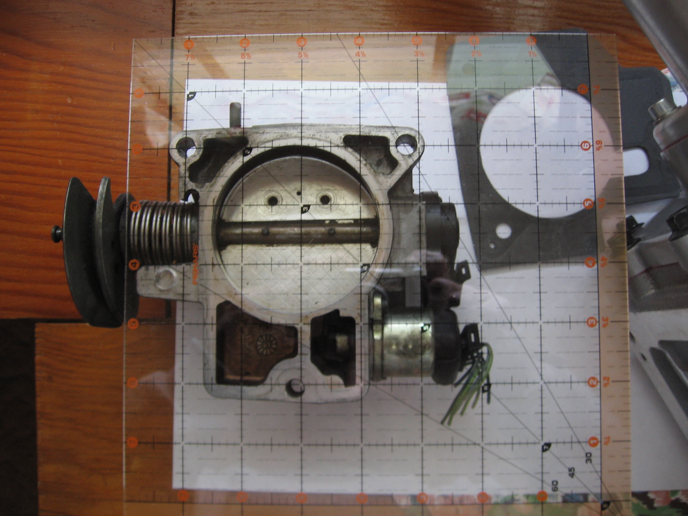

        While we're at it, can anyone tell me if the LX5 mounting bolt pattern is the same as this one? This is what I use now, but I would like to try the 65 mm.
        I need to make a mounting flange, and was hoping one flange could accept both. If not, a pattern of the LX5 65 mm's outlet side would be helpful.

          • 13513
          What TB is that?

            What TB is that?
            From a 4.3 Chevy 6 Cyl. The trouble is, it has to be modified to work. I had to use a different model's shaft with cable crank lever and plate, and had to rotate the TPS. I'd just as soon use the LX5 if I'm going to start from scratch, I assume that it needs no mods, except the cable bracket. And hopefully, it is readily available
            edit: the one in the pic is a spare I just picked up on Ebay, not the one I was actually using.

                Originally posted by chris_gt_74 View Post
                There is no off the shelf bracket I'm aware of other than the stock lx5 bracket which likely not work without modding and still may not work. That bracket is also thick as hell and big. I just put one on my 3400 and had to pick up an adapter from Ben and I had to modify my stock 3400 bracket which was a pain.
                That's not a problem, I already got a "universal " modded stock bracket Click image for larger version

                  Well then you maybe fine depending if the throttle body will match up. It's a 3 bolt pattern but I'm not sure if the holes are in the same place. One off center top and 2 bottom.

                    4300 / 4800 / 5300 / LSX TB's are all the same. 75mm, but the smaller engine TB's have a half-moon restrictor plate in them..
