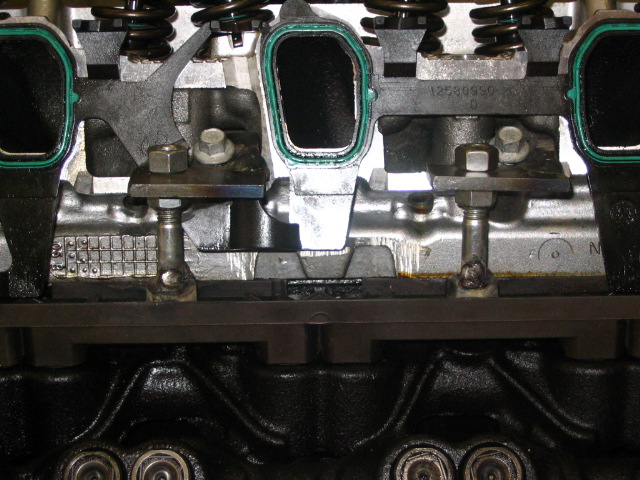

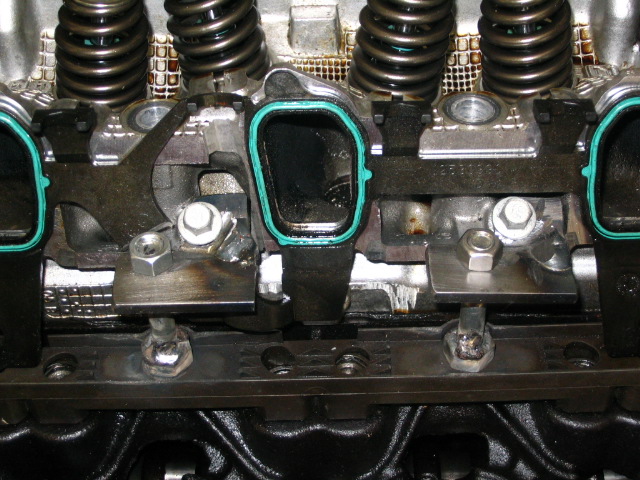

            I had at first set my 3.4 rwd up for the hyd. roller cam but went back to the 272 due to alot of people thinking that it would starve the bottom end of oil. Here is how I had my lifter guides set up, the bolted to the heads where the lim goes. I had studs for the lim and used nuts to tighten them down.

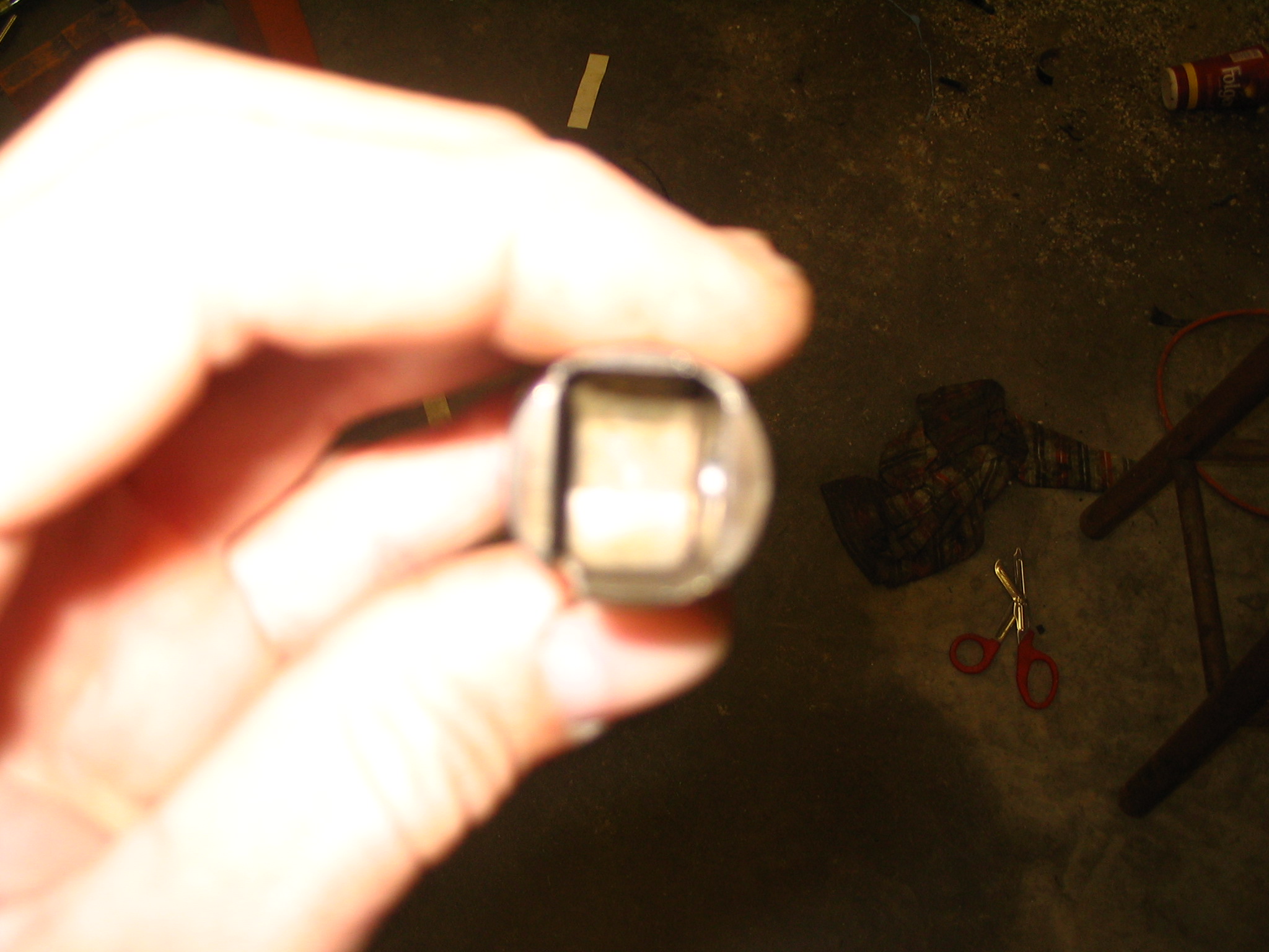

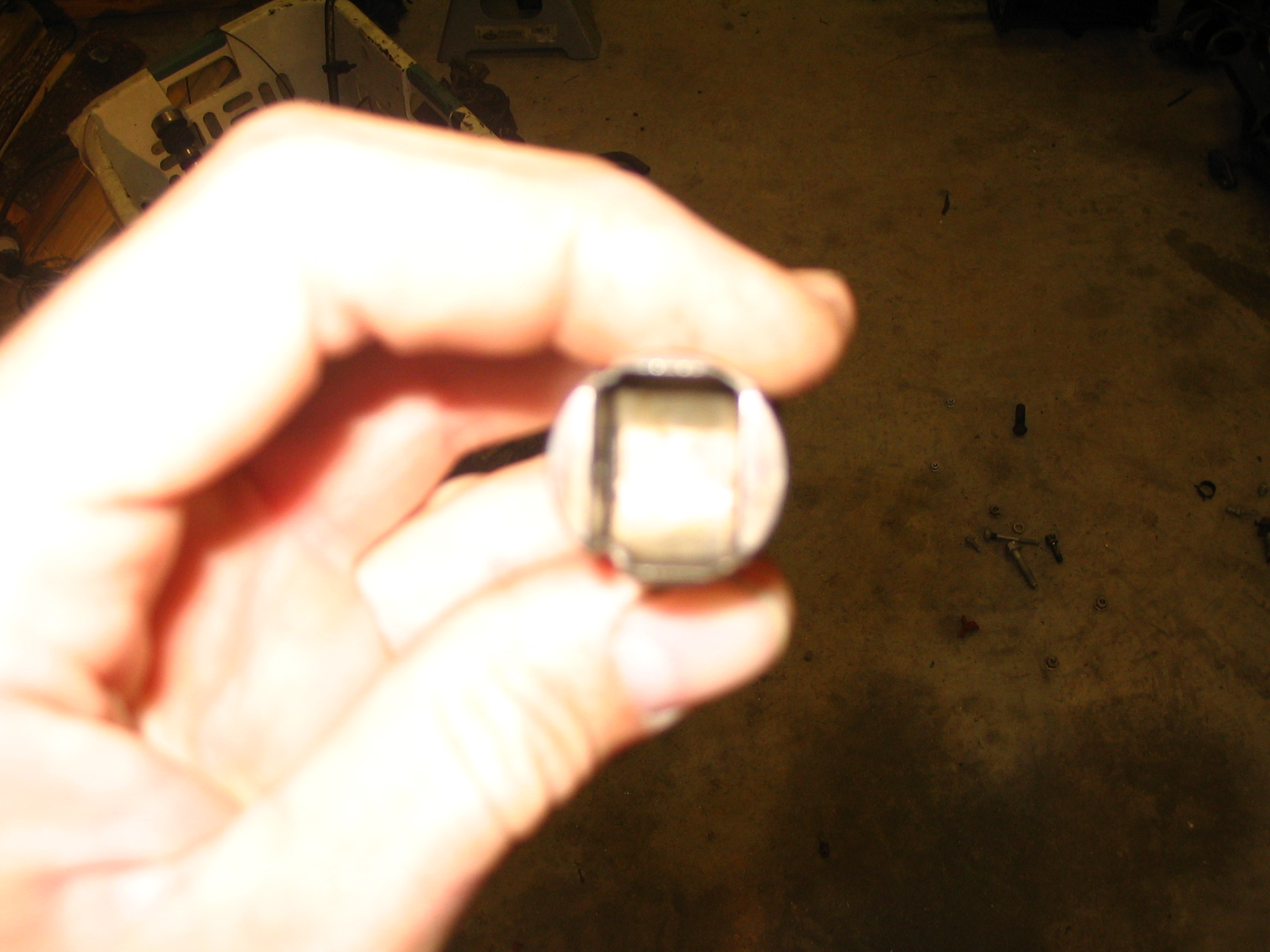

                  There was also a rumor about a small hole on the bottom sid of the lifter to oil the roller, so I tore one apart and there wasn't one. But the rumors still kept me away.

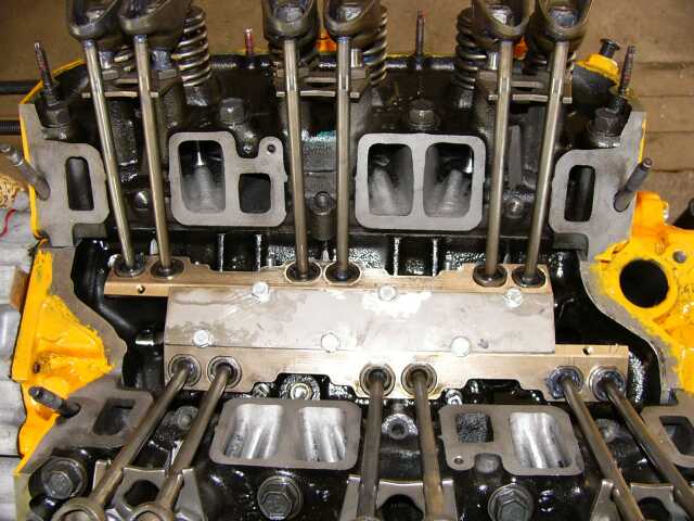

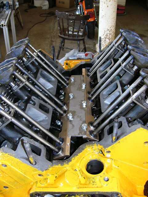

                      I don't know if anyone else has seen Kimmo's set up. It is a 3100 SFI cam, lifters, chain and pushrods adapted to a 2.8L Camaro block. He didn't use the stock plastic lifter holder things, but made his own to adapt to the old block.
                      I hope Kimmo doesn't mind that I post a couple of his pictures for demonstration.
                      I don't know exact details around oiling etc. but this was done approx. 5 years ago, and I'm told it runs smoother and more powerful. The 3100 parts cam from a 96 GP engine I picked up from a local auto wrecker.

                        Looks cool. I think if I were to try it I would shorten the link or make a new one for some SBC liked lifters.

                          I know about Kimmo's setup, and do have pictures of it. But unlike most people, Kimmo has access to milling equipment and can make things like this himself. For someone without access to the equipment, it would cost more than what its worth (IMO) to make a roller setup work in a block without provisions for it.
