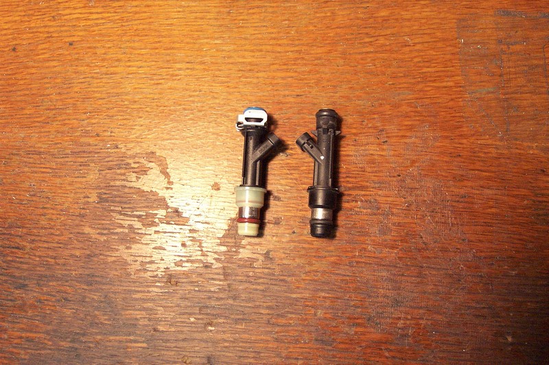

                          • 13530
                          I took a picture of the 4.2 trailblazer injector and a 3100/3400 multec 2 injector.
                          Are they rated for 28# at 43 psi or 55 psi?
