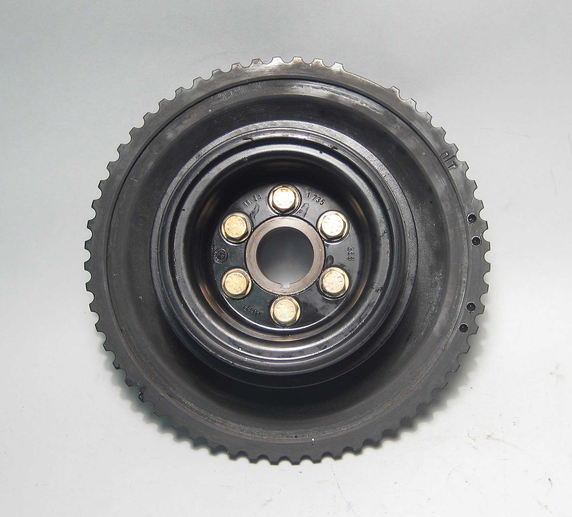

      "Harmonic balancer", Not "engine balancer"...
      Just because TCE does it, does not make it a good idea. You will NEVER see anyone else do this, OEMs, or major aftermarket manufacturers.
      Learn what an harmonic balancer is and how it works and then you might see why it's a bad idea and can cause unstable timing issues. I'll give you a hint: the outer ring moves differently than the the inner part of the harmonic balancer, and absorbs the shocks to the crankshaft that are created by each cylinder firing event. Ok, that was more than just a hint, but using notches on an harmonic balancer is a really bad idea. The other issue is the outer ring ever slips, which is not uncommon, the timing will then be off, causing the car to not even be able to limp home. With a proper trigger wheel the car can at least be driven home or to a repair shop.
      BMW has always had the 60-2 wheel on the outside of the damper...
      • Guest
        #138
        I find that hard to believe.
            I am 100% sure. We have tons of Bavarian in the shop.

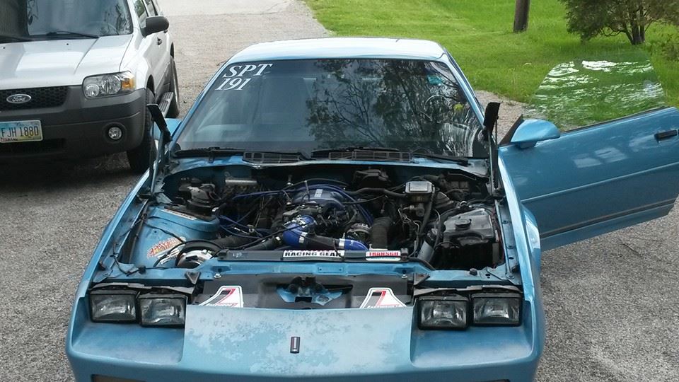

                You could be right. But I ordered it anyways just because i spent 2 solid days out there messing with it with no luck. I know the first ICM i had was bad but the used one i have now is good, I even got a brand new one for 90 bucks at orilies because I was so irritated and stressed out. The wireing just to make spark is correct. The sensor ohms are good and it was producing a distinct ac signal but that may have been the problem. If this new wheel doesnt solve the problem then I will know for sure its not the wheel and that part of the system. BCC is shipping the wheel tommorow, being that they are located only 2 hrs away it should be here in 2 days so I can see if it was that or not.

                  The wheel didnt help....but
                  So I said screw it and got a new sensor and wired in a different power source because i was in a rush today and only had about 10 minutes to play on the car and what happen...... it F-ing ran! Not sure if it was the sensor yet or the power source cutting out but it runs and I can work on it this weekend to break it in completely and make sure everything is ok.

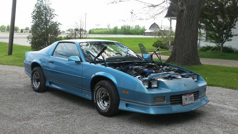

                                #150
                                My guess... 123456 would be the order.
                                Updates. I just need to toss the hood on, go renew my tags, and take it for a drive and tune it more. I added just a little fueling to the part throttle and WOT and dumped 1 degree of timing all across the board in hopes that i can at least drive it around the block on that tune and get a guess on how those heads, headers, and such effected my tunes from last year. I drove it back and forth on my drive way for quite a while just because. Dont laugh!
