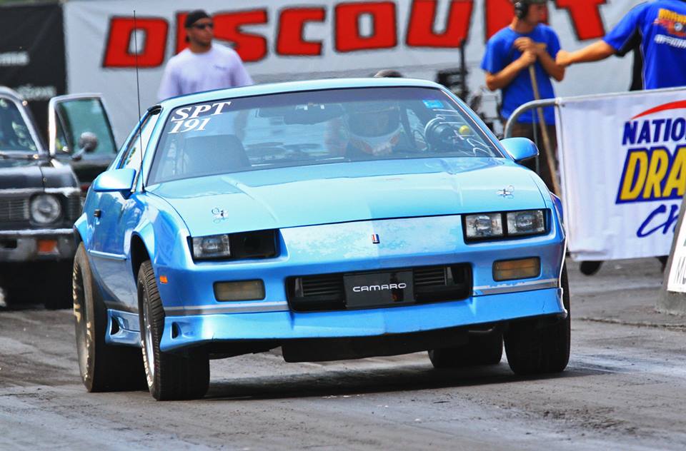

                      Update 21 Passes later the car is still running good. Solid 12.50-60 car at 13psi. Love the hybrid setup.

                          Well I picked up about 7mph average on trap speed at the same boost level as last year and picked up a solid .45 of a second on the 1/4 mile time. The tune actually has less timing then last year, but about the same boost. 13psi

                              The top end hybrid swap did all the work. The car actaully pulls very hard down track now. Before once 5k rpm it would start to slow down and you could just tell that it was restricted. The higerh compression compared to my prevous, the tube headers compared to last years log headers, the dis, the intakes, and aluminum heads, all helped to make the car have a better overall combination on the RPM areas where I use to lack the power i wanted.

                                Little update. 37 Passes to day: New best is 12.25@114mph. Finally got a 7 second 1/8 mile time. Running 14psi of boost now but still footbraking.
