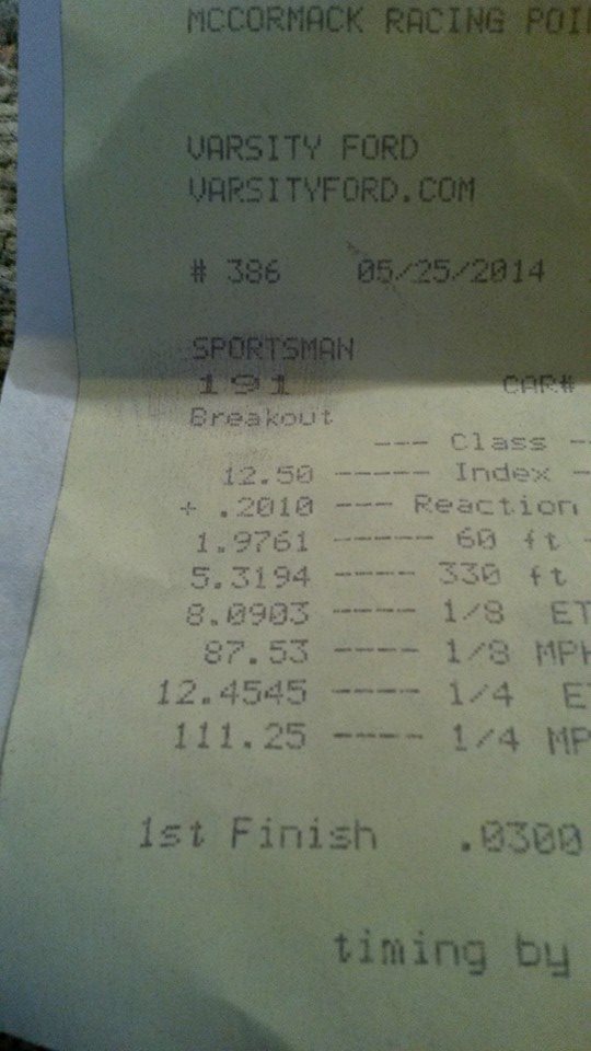

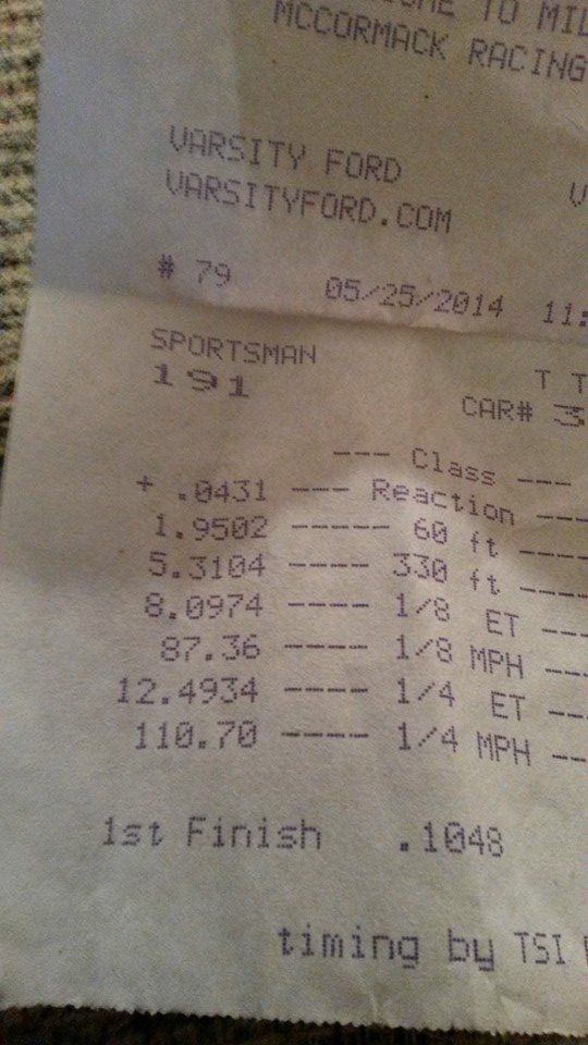

          HIt the track today!
          I added 2 videos and a few slips for ya to check out. Totally fell asleep on the 2nd round and had such a horrid light. Been a long few days...to get the car tuned and ready but it ran great. Drove a 120 mile round trip also and it did well.
          I love not having a screamer pipe now. All i can hear down the track is the turbo and some throtty exhaust. Love it.
          Did i mention that this car is surprisingly consistent! Love that alot.
          First time at the track with hybrid - YouTube
          First time out. 1st round on brakes for the win - YouTube
          1/4 mile best 11.59@119mph

                  Running abour 12.5-13Psi of boost. And the tune is very conservitive, the timing is 2 degrees lower then last year at that level. 17.5*ish at 13psi.
                  Im very happy with the times so far. Considering I was launching at arround 1700rpms and I have a 3000 stall on it, the 60 ft times could be alot better and drop the ets in time. Last year I could hold and launch at arround 2600rpm and catch 1.7x 60 foot times. Yesterday i was knocking down 1.9x 60 ft times.
                  Last year it felt very slow at the top end of the track. This year it really drags you down. I gained about 7mph on my trap speed. Last year I was averaging 103-104mph. So im loving the hybrid set up alot. Much better flow at high rpms.
