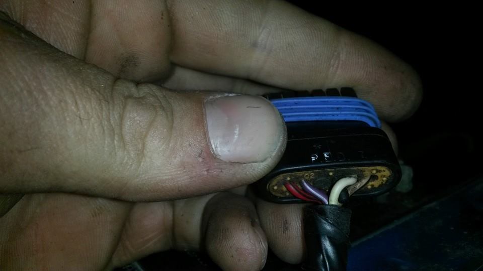

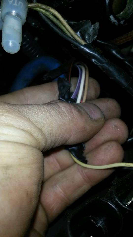

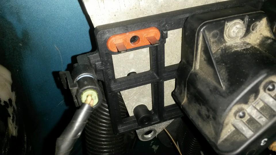

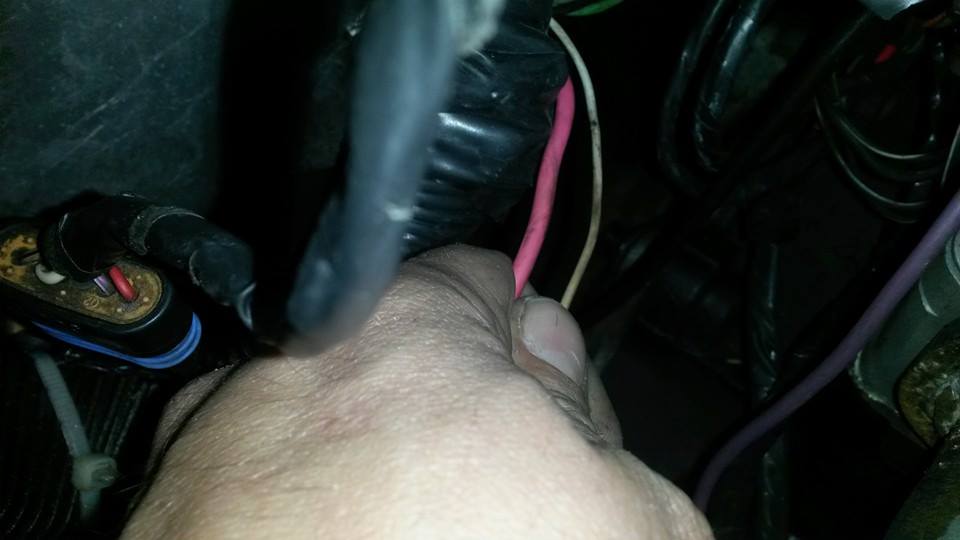

Added some pics of the wiring.
The 4 wires, est, bypass, ref... are all in that one pic where 4 of them come out of the main wire loom about at the middle of the firewall(the colors all match the orignal). Then there is the 2 wire Red and white coming out of the pass side of the fire wall main loom. B is my positive. I used the red only and even went as far as grounding the ground directly to the battery.
I have 12 vdc or so at the connector at the icm but still issues getting the proper voltage out of the coil terminals.
This will sound stupid but if I go across the coil and the key is on i am getting 0 vts but if i go to the + termial and then a body ground is 12 for the one side and then if I got from - to the bat I get 6vts. This is when the icm is not grounded at the 2 prong clip but fastened tight to the mounting plate which is grounded. This only happend because I accidently janked the wire off of my grounding spot and noticed my meter change numbers.
Now this blows my mind. When properly grounded and hooked up at the icm, the + coil terminal to ground, drops to 0vts. The coil ground terminal to the ground is 0vts. Going across the terminals on for the coil when the icm is grounded is also 0.
Strange stuff. But I posted some pics so if anything looks wrong i really appreciate it.
I can tear back into the loom but the 4 wires come out as one group and the 2 wires come out as a group out of a different section of the loom.

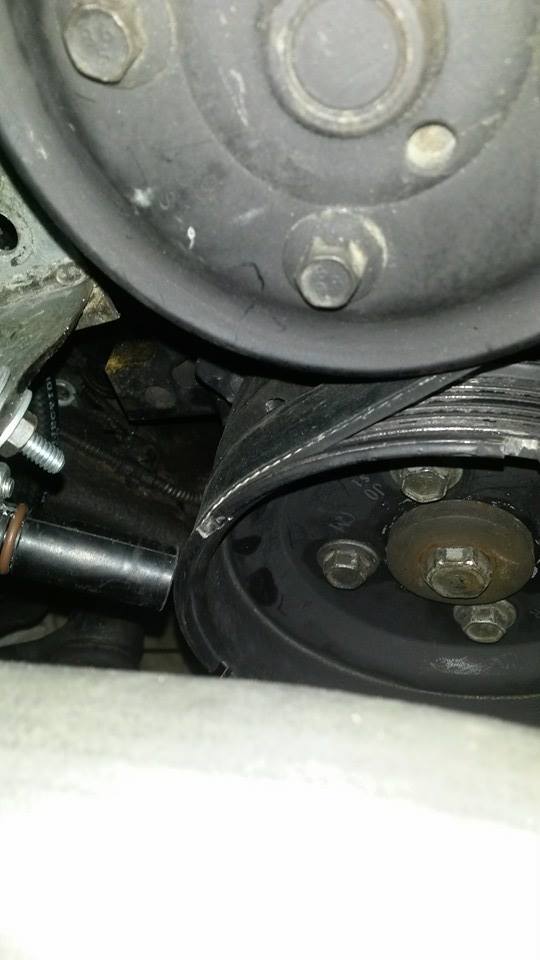

Also if you look at the angle on the wheel it looks like its not seeing the notche bottoms completly. Not that, that would cause what is going on right now its something that i will have to adjust.Last edited by fasteddi; 04-14-2014, 03:35 PM.BorgWarner S366 3.1/3100 Turbo Thirdgen

I didn't realize that you were using the front edge of the pulley to try to use as a trigger wheel. That will not work. There isn't enough material there to cause the sensor to switch states. The trigger wheel needs to be at least 1/4" thick. This would also explain the low voltage on the trigger signal, though I haven't actually measured mine to compare.
You shouldn't be getting any voltage across the coil terminals, with the engine not turning over. Inside the ICM there are 3 transistors that drive the coils, and these will all be off without a trigger signal to the ICM. The 12V at the positive terminal is a good sign. The 6V is expected when the ICM is not grounded, I won't go into the details of why, but it makes sense from an electronics standpoint. Make sure that ground is solid!
So you need a better trigger wheel for this to work, before you do anything else, rectify that. I'd also replace that pulley now. There's a reason why there is a raised lip on the outside edges of the pulleys, and that would be to keep the belts on. Even with "perfect" alignment the belt will want to wonder and the notches that are there now will chew up the belt.
I'd also make the trigger wheel a larger diameter than the pulley if you attach it to the front edge, so that the edge of the pulley doesn't interfere with the notches. I know that sounds like I'm contradicting myself here, but when you have bits of metal next to each other trying to manipulate a magnetic field there can be strange things happen to the magnetic flux that is part of this whole process working.Last edited by Guest; 04-14-2014, 06:58 PM.

Look at the damn picture, it's the outer edge of the pulley he's trying to use, so go cough yourself...Originally posted by Maverick H1L View Postcough "outer edge of damper" cough...
And if you're suggesting to use the outer ring of the harmonic balancer, this is a bad idea for several reasons, most notably of which, the timing will not be stable, due to how the harmonic balancer works.

I'm fully aware he's trying to use the outer edge of the PULLEY as the timing ring. I saw the earlier pics. Which is why I'm suggesting to use the outer edge of the DAMPER as the ring.Originally posted by The_Raven View PostLook at the damn picture, it's the outer edge of the pulley he's trying to use, so go cough yourself...
What's funny is TCE sells their external CKP kits WITH THE NOTCHES MACHINED IN THE OUTER RING OF THE DAMPER. And what's also funny is I bought one and have NO timing issues. Well, once I fixed their mistake (they mounted the damper to the fixture upside down and completely screwed it up).
AND IT'S A DAMPER AND NOT A BALANCER. THE DAMPER HAS NOTHING TO DO WITH THE ENGINE BALANCE. IF THE ENGINE IS EXTERNALLY BALANCED, THE WEIGHT IS GENERALLY ON THE FLYWHEEL/FLEXPLATE. THE CORRECT TERM FOR THE THING IS "TORSIONAL DAMPER".
These notches are on the pulley not the damper.
