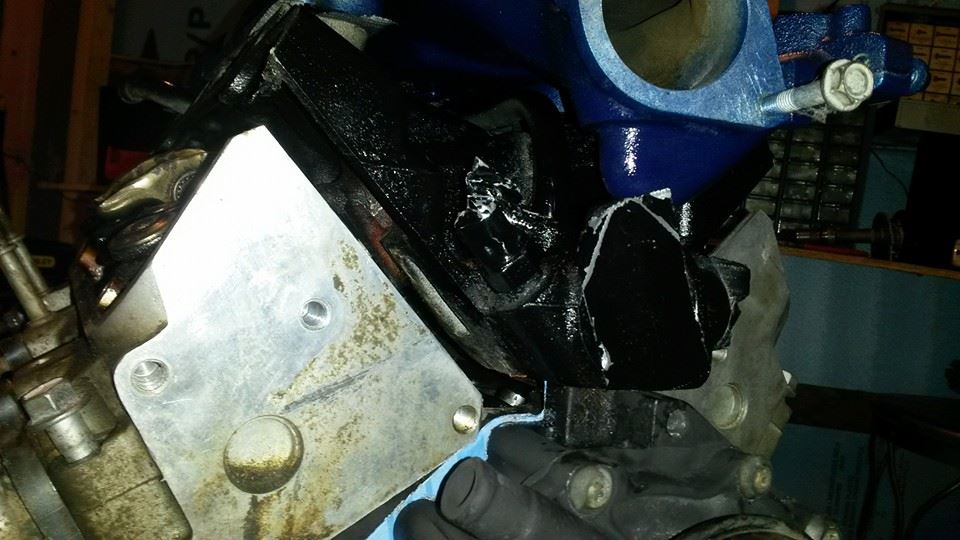

ID:	377692Did you have to just cut the upper lip of the timing cover? I started to fit some things together while i await the pushrods and noticed that the lower intake will not sit down from the timing cover but didnt wana start hacking things up till i was sure.

        #63
        Yep, chop it off.

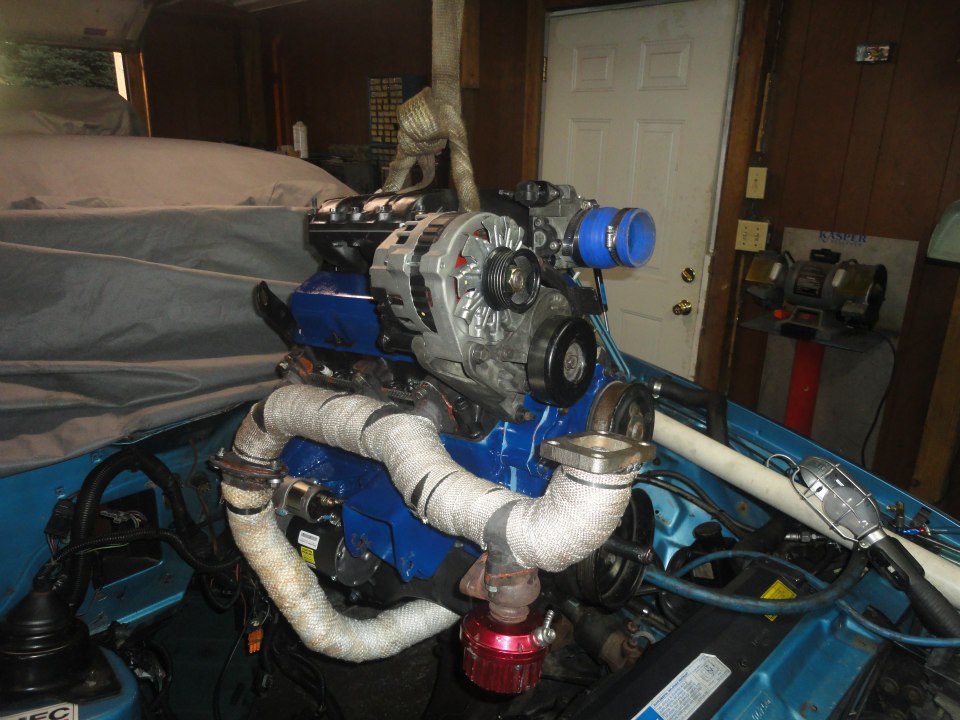

              Sounds good to me. So i just have to get the intake to fit on, wait for the push-rods, but in the mean time i'm tossing in the engine this weekend so i can start building up the drivers side header and figuring out how to get my accessory to fit and so forth. Should be interesting along with the DIS. Ill be honest been putting off the whole dis thing because of the ring I either have to make or notch out that pulley...that is new territory for me.
              Too bad its not as easy as last years build. (the pic attatched) that was a cake walk.

                #67
                Yep, chop it off then you'll have to grind it down a little bit more to make sure you have enough clearance for the intake to seat when you torque it down.

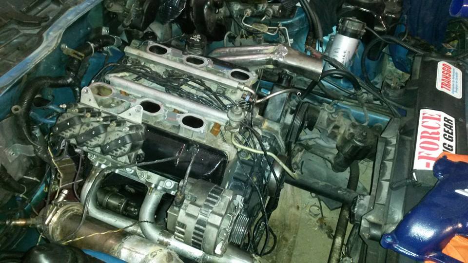

                  Made some progress fitting up some of the pipe so I can make up the drivers header.

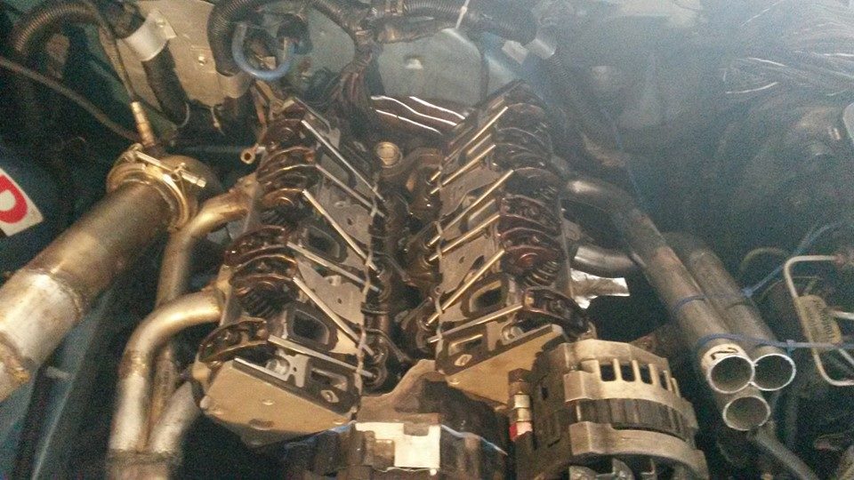

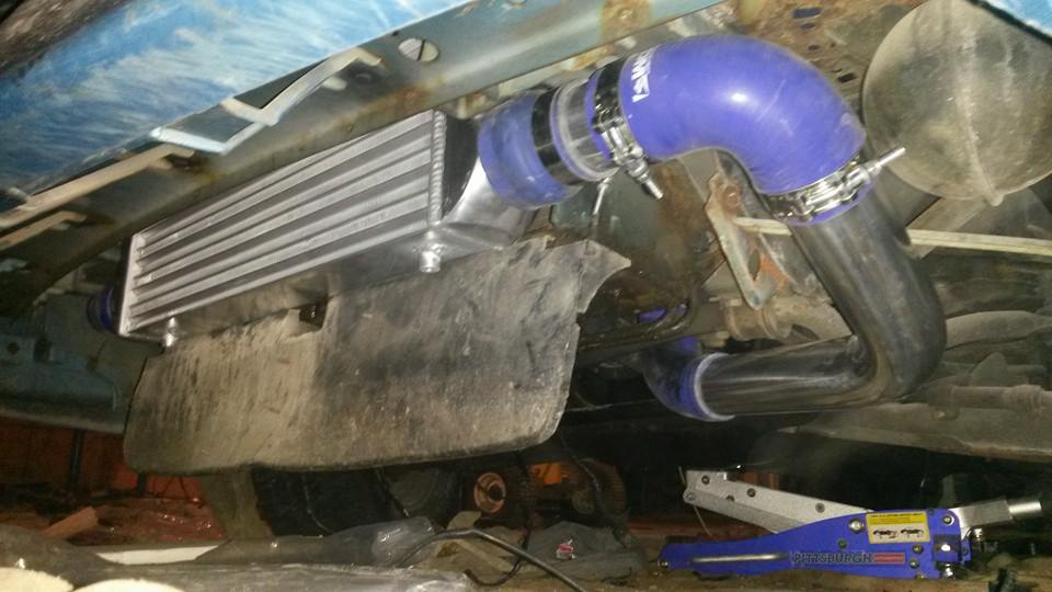

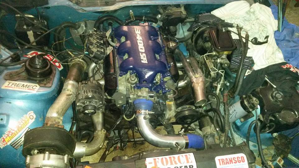

                    #69
                    Some updated pics.
                    Build is going well. I still need to get a different throttle cable and get the radiator situated with a 2.8L fobody one for the intake of the rad on the pass side. But else then that its just alot of little things that im working on.
                    Still aiming to get this puppy going by april/early may.

                        I used the original throttle cable for an S-10 in my truck, but had to swap throttle body arms with one from a TBI S-10 and made my own throttle cable bracket. I went a better way in my Datsun (using a 3400 throttle body), where I was able to use a stock throttle cable bracket because I used a mid '90s Buick throttle cable. I don't recall the exact model, but the cable is quite long and works well in longitudinally mounted situations. It's almost too long for my straight 6 engine in my Datsun.
                        You can see the throttle cable in the following picture, it exits the firewall, passes between the two reservoirs on the master cylinder runs along the fender and then turns back into the throttle body, using a standard car throttle cable bracket. It will work equally as well with a 660 mounted longitudinally. Pedal feel is nice, I'm also using a progressive throttle cam, which makes driving nice.
