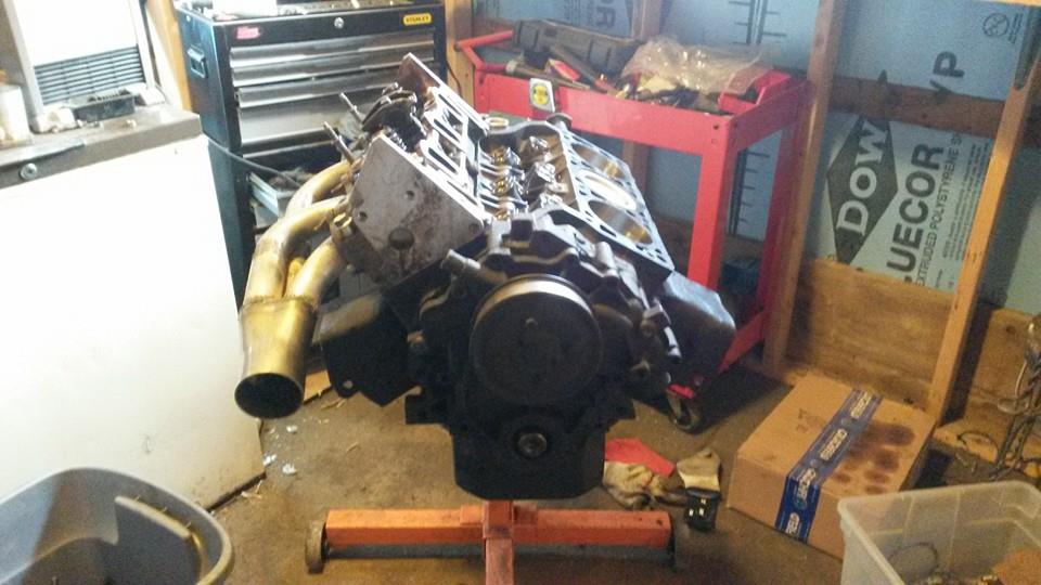

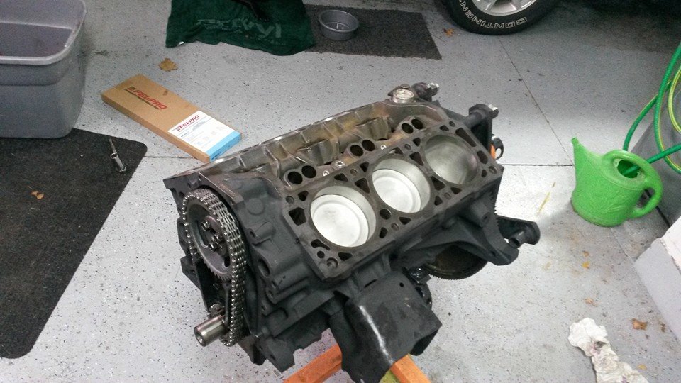

                          Made some progress over the weekend. I do have one question as i'm getting ready to order 6.287 and 5.937 inch push-rods. Do I use guides on my 3.1L iron block? If so which ones and how to I make that work? I wasent sure If I used them or not but I need to find out some info because I don't know If I need hardened pushrods or not.
                          Thanks for any info!

                            Whether or not you use guides depends on what rockers you're using. If you're using the stock 3400 rockers, you can't use guides. If not, you will need to find a set of guides for a 93-95 3100, and I'm not even 100% sure those will work. As for me, I merely cut the iron head pushrod guides and mounted them. BUT, the iron head guides WILL NOT WORK in the corners of the cylinder heads without some sort of machining to the intake.

                              If I'm looking at the picture with the head on the block, it looks like a roller fulcrum rocker, that is self aligning. No pushrod guide needed for that.

                                yea there just 2002 3400 rockers so there fulcrum. Thanks
