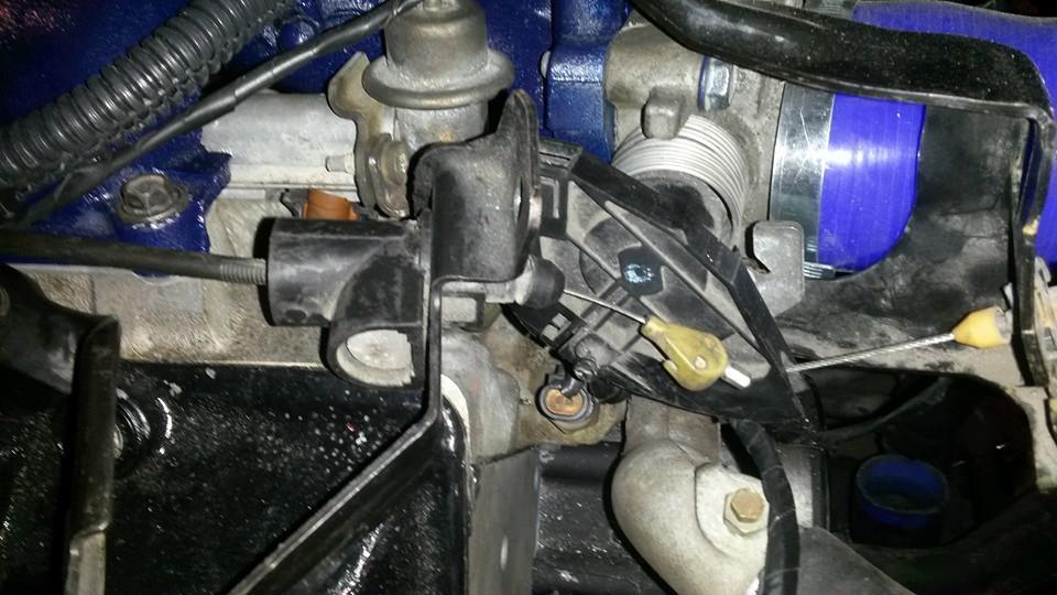

            Stock TV cable isn't going to work for sure with that cable bracket. I don't know of one that's long enough.
            I used a LS1 75mm TB on mine which was set up to pull to the rear, even then i had to make a custom bracket for the throttle and TV cable to work. I also had to make my own arm and weld it to the TB to get the correct pull on the TV cable, then use parts from a throttle cable kit. Was a pain in the ass.. lol

              I had good feeling that it wasent even going to be close. Ill have to work on it sunday and hopefully figure out what will work. Those pics help. Thanks.

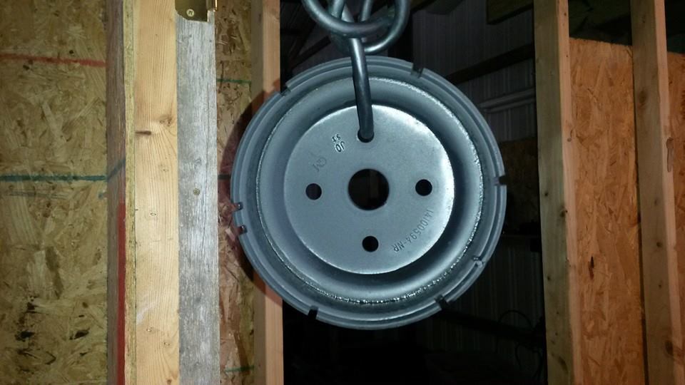

                            Still no spark or injector pulse!
                            Ok pics of the reluc wheel are attatched and Im using a 7x sensor off a 3.4L fbody.
                            The wheel is set so that it has 10* base timing and the sensor is ligned up to the trailing edge of the 1/4 notch with the stock timing mark showing 10*btdc on cyl 1.
                            The sync notch 10 degrees after the 1/4 notch.
                            Max advance of 0*
                            refernce angle of 70*
                            max retard of -60 all set in the bin.
                            Wiring is this as I've literly spent 3-4 hrs rechecking and rechecking and i think im starting to go nuts... I just want it to fire.
                            CPS is purple and yellow. (I also tried to reverse them and still no spark)
                            The 2 plug is termial A system/chassis ground and B is the 12vts+ Pink is hot.
                            The 6 plug is: All matching colors but there is no tach output on the dis plug as the car it was on did not have a tach. So i didn't splice that in yet. My tach wire is just taped up and sitting right now.
                            I messed with the position of the sensor some more and I constantly get the same .3xx to .8xx volt ac varriation as the sensor sees the notches come and go. I also ohmed out the sensor and get arround 900 ohms which i believe is normal even though the sensor is new i wanted to make sure it checked out ok.
                            The cps sensor is about 1 or 2 playing cards away from the wheel so it is very close. Mabey too close?
                            Is there anything else im missing? Could the module be bad? It was good on the impala last time it ran.
                            I tried just tapping the sensor on metal constantly with a rythem but still no spark. I tried it without the ecm attached and still nothing, not a hint of spark. I tried alot of things today and failed so im a tad bummed out. But hopefully i can get it going soon.
                            1/4 mile best 11.59@119mph
                            1/8 mile best 7.47@94.9Mph

                              Well, first off, the rule: "No spark, No squirt". If there isn't any spark, it's a good bet your ECM isn't seeing any reference pulses, so it won't pulse the injectors.
                              Your wheel looks okay to me, provided it's timed right in relation to the #1/4 pistons.
                              The sensor is good... I seem to remember getting numbers somewhere like that when I was having my issues. And the gap is good as well, about the same as mine.
