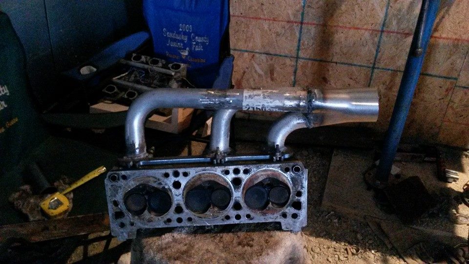

                            Made up the passanger header finally. Turned out well. Cant make the drivers side till the engine is back in the car. Pic attatched.
