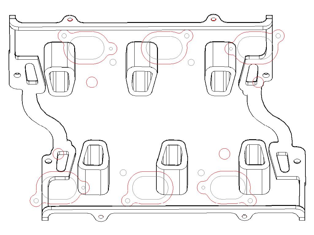

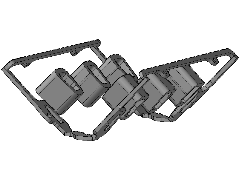

    Got a little more done on the CAD model today. Now I just need to figure out how the rest is going to be built....

        There really isn't an SC in mind. What. I am currently designing will be a generic base for the 3x00s, that will allow for different top pieces to allow for carbs, standard EFI, and SCs. We'll see if it works out that way or not...

                Well, I should have had my spare manifold with me while I was modeling this, as I had it all jacked up. Figured it out when I started to overlay a CCM of the 3400 ports that I received from Marc a few years ago. While lining it up, the ports from the CCM and the ports I had modeled didn't line up very well, so I decided to bring in my manifold to compare it to what I had on screen. Needless to say, I had to rearrange several of the parts, flip them around, etc., but finally got it where it appears to be correct. So now that I have that figured out, its time to start with the modeling of the coolant passage/thermostat housing, and then the cavity that the ports will go into.
                Anyway, here is a top shot of the model with the 3400 port CCM overlay-edClick image for larger version

                        Making a little progress on the coolant routing/thermostat housing. I started trying to build it out of pieces of 1/4" material like the rest, but soon figure out that just wasn't going to work out well. So I have now moved to blocks of material with bored holes. And since I am trying to make this as a potential part for daily drivers as well as custom builds, I am trying to maintain all the standard connections (bypass, heater core, CTS). Its proving to be somewhat of a pain, but I'm sure I'll figure it out eventually. So, no picture updates tonight, sorry...
                        While searching around last night, I came across the following post: http://www.mopartech.net/showthread.php?t=7560
                        Hopefully we'll have a build thread like that for this manifold. Also made me think I need to go down to 1/8" for the cavity area, instead of keeping with 1/4" throughout.
