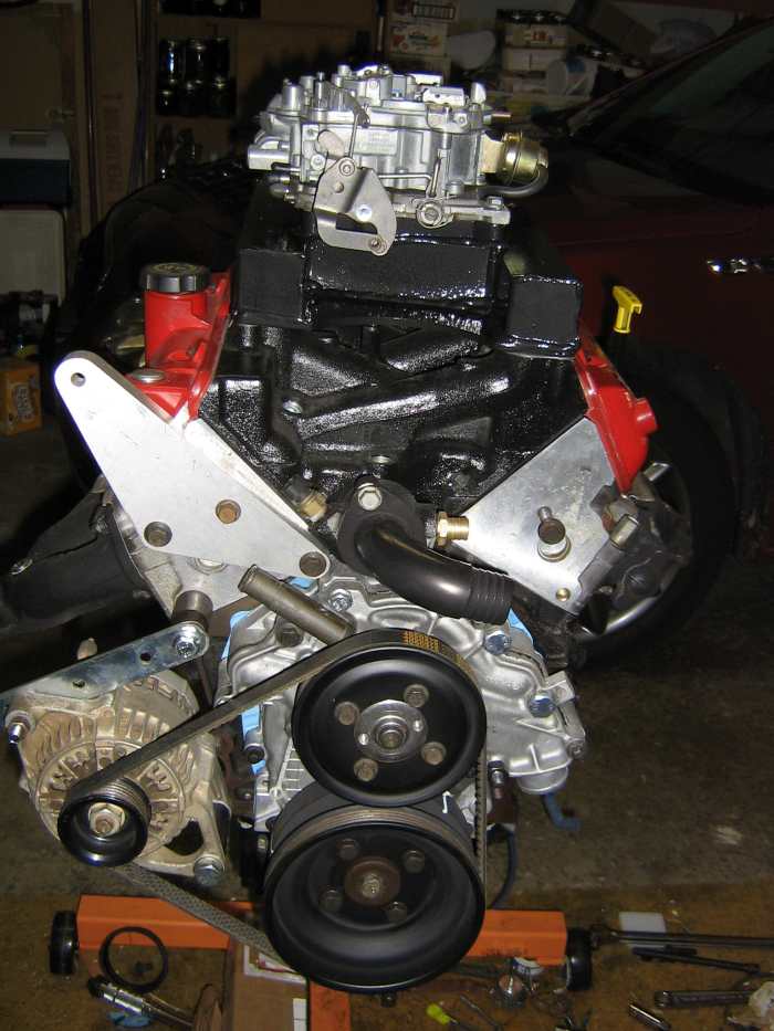

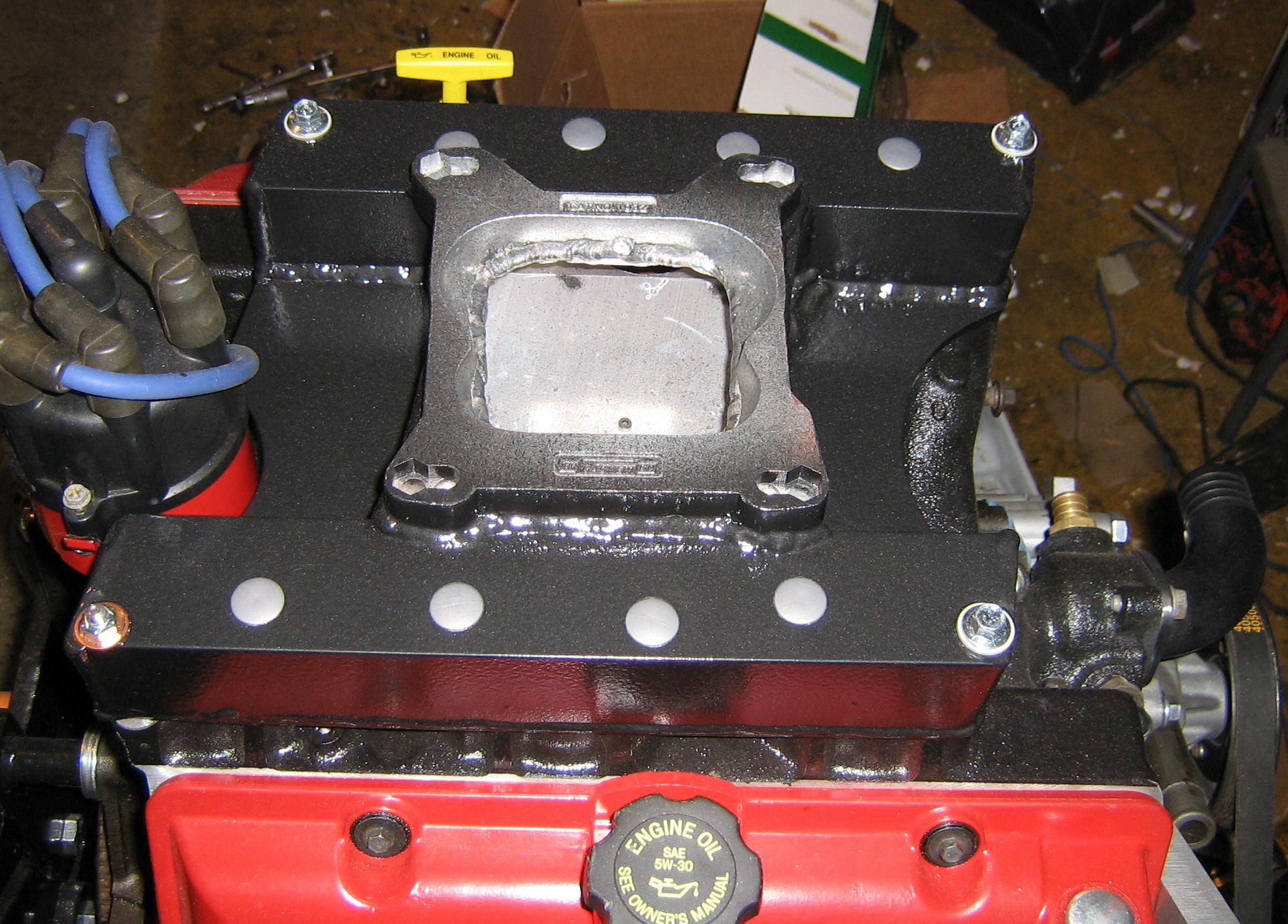

                      Bolting down a custom upper intake is easy, just build it on a 1/4 inch thick aluminum plate, cut holes to match the LIM and then put anything you want on top of it. Mine was dead easy to do and bolted down perfect. If you want round just split a tube and weld it on. Sorry mine is painted black so it is not easy to see, but I think you will get the idea.
                            Larry
                            [ATTACH=CONFIG]7224[/ATTACH]
                            [ATTACH=CONFIG]7223[/ATTACH]
                            yeah, it would require some kind of a bridge to go across the top so it would bolt down evenly.
